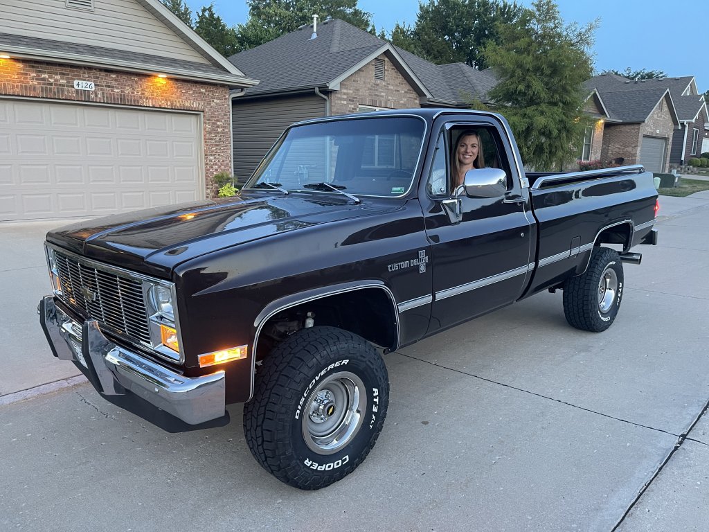

Changed all bulbs on entire vehicle to LED. Everything worked perfect. All of a sudden, a month later the side marker/turn bulbs are burning faint rather than bright. Checked bulbs in another unrelated socket and they work fine. Thought it could be a ground issue but the front marker/turn bulb is burning bright so if it were a ground issue, I think they are on the same circuit so I’m confused. Both left and right side affected. Any suggestions?

I understand all of this and am willing to concede that LED’s are the culprit. I just can’t figure out how the bulbs still test good at battery and they were working. Here is the photo with them working right after I put them in (and functioned just fine) and somehow now they burn dim. The only correlation to an “event” was when I changed all dash bulbs to LED as well.
