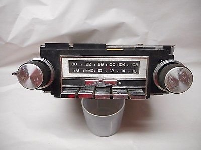

Stock radio plug(s) ? GM 2700M

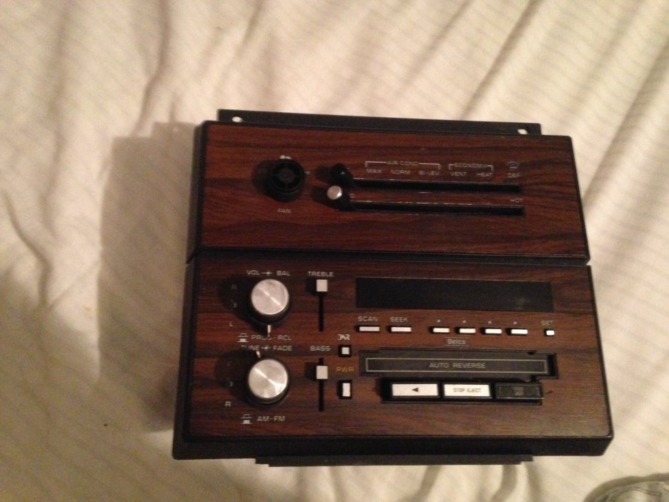

Hi.
I bought this beaut for a cool Jackson, originally for looks, but the guy said it worked?
Hmm....So....Huh. The longer I think about it, the more I like that idea.
I have looked a little and found nothing terribly useful - trying to source the plugs for the back.
I gather there are two. One for power / ground and the other I guess for speakers? In the bottom corner?
Any input regarding factory/repro plugs will be awesome.

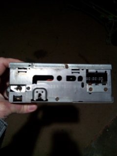

Basically the black, white, and blue plugs all plug in together next to each other. They are keyed so they only go in one way. I believe one is for power, ground etc. One is for front speakers, and one is for rear speakers. Pretty simple. I just had to adapt them to the sony DIN stereo I just put in. If you have a Chilton or Haynes the books have the wiring diagrams.

That's the right harness, the eBay one. It's meant to work with an ETR radio, too, because it has four plugs, but you should only need three of them. It'll come with intructions if you find any stock wiring back there. I just bought one of those harnesses, and I'm getting there on figuring it out. The radio is backlit, and I think the Haynes manual might have a little write up on how to change it, not a hundred percent, though. I'll see if I can find pictures. Twenty bucks is a good deal. If it doesn't work, and you want it to, I have a radio service manual, and I can take pictures of what you need. I have two of the 2700's and two ETR's so I felt like I needed the manual to help me rebuild them if needed.

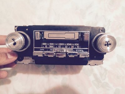

Haha, an ETR is an electronically tuned receiver. That's a crazy good deal, though. I got one like yours a month ago for sixty, and I thought I got a great deal (that's the only reason I bought it). I've seen the 2700's on eBay for money that I would never pay for them, especially when private sellers have them for dirt cheap, and I've seen them in junkyards just sitting there. I've been doing my wiring today in my Caprice, it's the same as on yours, and I've found that the color coding they suggest the factory harness should look like is not a hundred percent, and they didn't match their harness to what they said it was supposed to look like. It's coming along, though. I'll show you some pictures of what I've done in a bit, but here's the radio I've been working with. I've fixed the buttons, and it's supposed to work so fingers crossed.

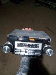

This is the 2700 that I picked up for $60. The guy met me well out of his way so I gave him an extra ten. The radio was advertised for fifty as a working unit that came out of an Elco.

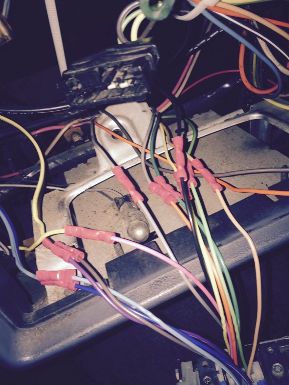

Here's my wiring. I jerked out the jumbled mess that was used to power two different aftermarket HU's, and the stock harness was behind it all. Not all of it matched the diagram, but I did some tracing, some guessing, and some praying, and it all worked in the as of just a few minutes ago. Note that some of the wires match, some kind of do, and some don't at all.

The harness plug sockets in the back identify that radio receiver as post 1977. That distinctive 3-gang, 4 pin style socket was initially introduced in 1978. The connectors supplied power/grd/backlighting to the receiver and provided inputs for the frt & rr speakers.
It remained as the standard connector style for the base stereo system until at least 1991 - that is the year my diagrams stop.
Original part numbers for the connectors are 12004543/44/45 - from right to left (as viewed from the back of the radio).
Connector 12004543 (far right, looking at back) used only 3 pins. These were for:
1. Main power supply (YEL lead - pin F, supplied by the RADIO/IDLE fuse in the fuse
block, only hot when the key is in either RUN or ACC)
2. Dial backlighting (GRAY lead - from pin M, supplied by the instrument lighting circuit,
voltage controlled by rotating the H/L switch knob)
3. Ground connection (BLK lead - from pin G, through the common splice point and
terminates at the ground bus block)
bus block)
Connector 12004544 (in the middle slot) power from pins A, B, C & D to the front, underdash speakers.
Connector 12004545 (far left slot) power from pins H, J, K & L to the rear B-pillar mounted speakers.
See the wiring diagram below for speaker bias and polarity wiring details:

The rear speakers are on the inner bedsides almost to the tailgate. I was just gonna note that this wiring diagram is very similar to my wiring diagram for dummies with the exceptions of the power antenna wire and the digital clock 12V wire.

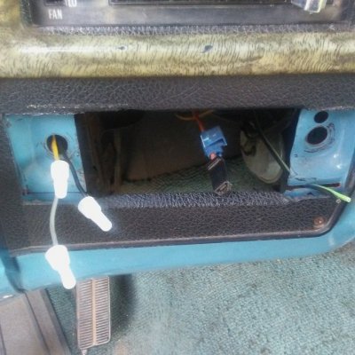

I went diggin to in my dash and found six wires.....
That's all there is.
I sure do got a lot of stereo plug to only have three wires! Lol?
:bawl:
Naw, it's perfect. That's all that needs to be there.
Guess I really will have two systems. It'll be BAD.ASS.
It'll have to keep waiting but it's getting​ closer AND warmer!
