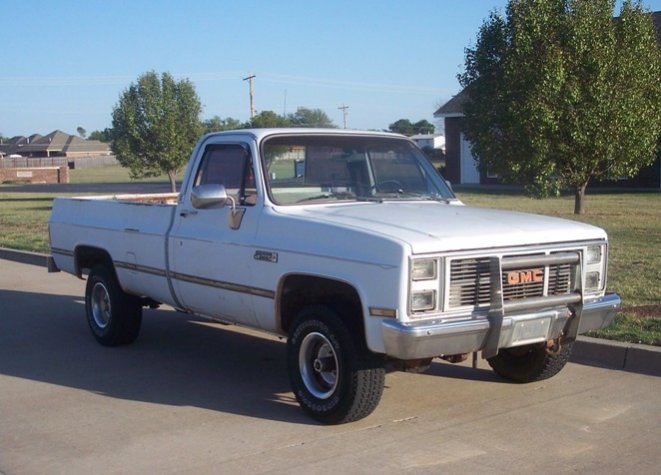

This is my K1500 with stock 31x10.50x15's and OEM height without any lift. Just a hair taller than my OEM height C20. I hope to go 4in and 33's at some time.
