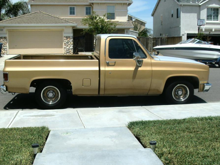

right on! im feelin ya on that... my dad did the same thing to my truck when he had it... cut one coil from the front,.. and pulled the overloads.. and there it is.. a bit rough ridin too.. but when I go long distance.. I toss my toolbox and a 90lb sandbag in back along with the spare.. settles it down.
