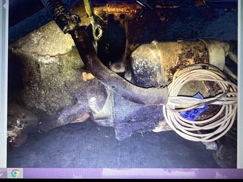

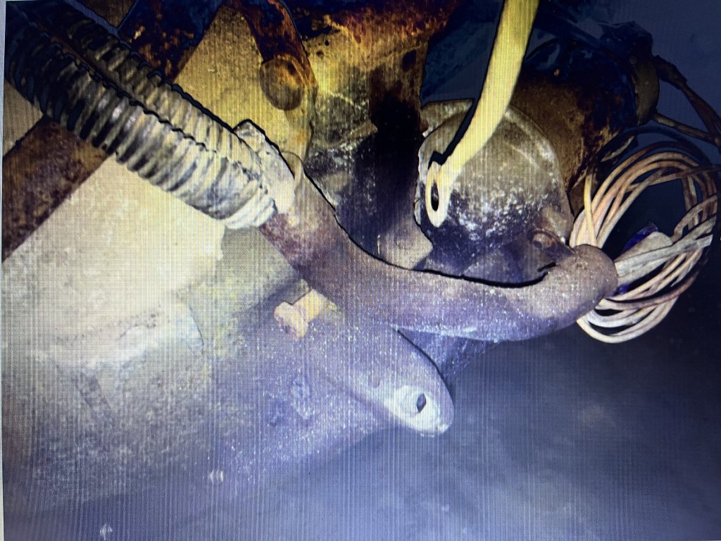

HOTFOOT
Feb 29, 2020
485
1,076
northwest ct
michael
gmc k3500 srw
My 80 k3500
