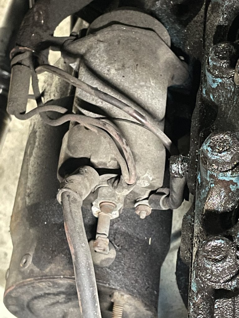

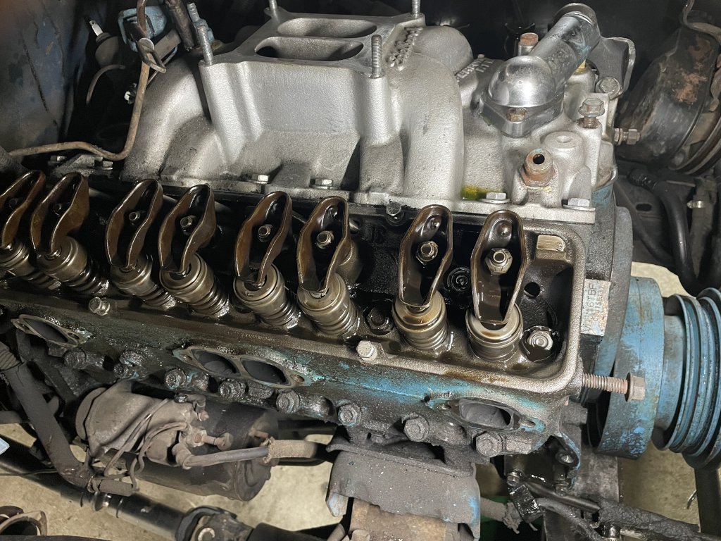

I don’t know if this will help you out or not. These pics are out of a K 10 1979. After going through four different alternators, I went with the tough stuff, one wire alternator, and haven’t had any problems since. Just ran the one wire right to the positive side of the battery.

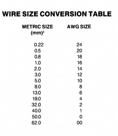

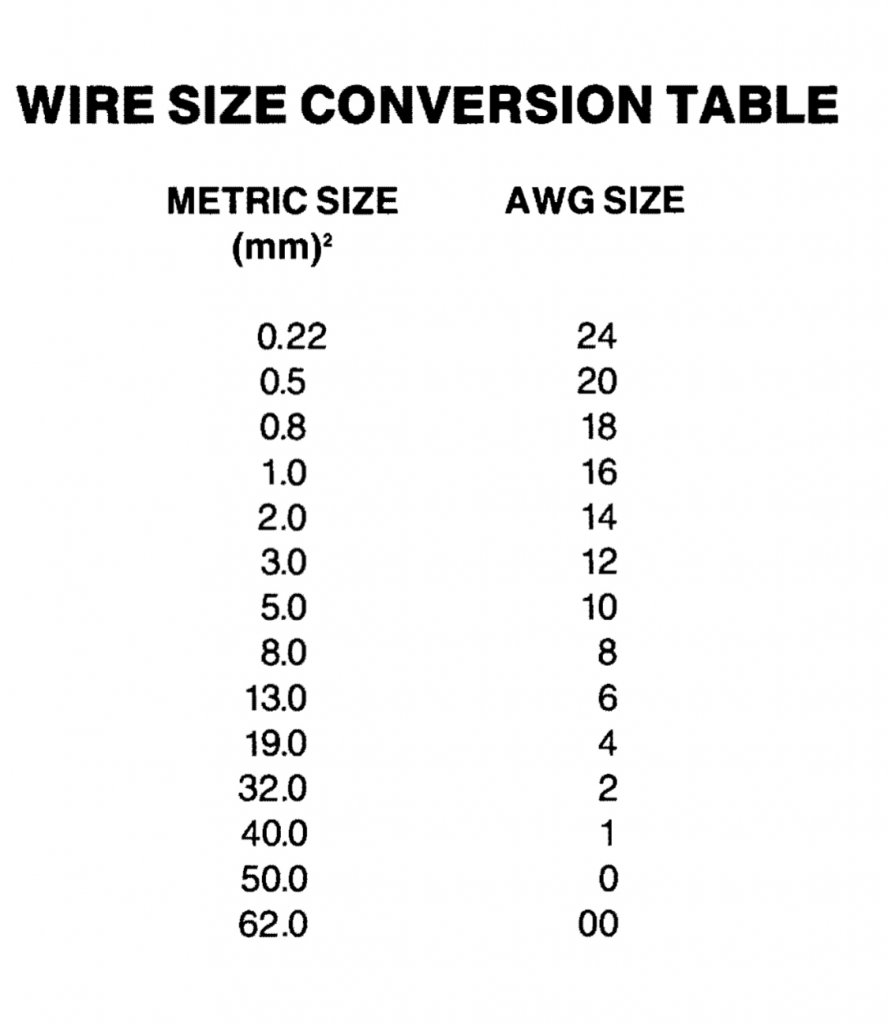

Just a FYI- On the wiring diagrams the first number (before color) is wire size in metric. The number after the color is the circuit.
Example 3 PPL 6 would be 3mm Purple 6 = 12 gauge Purple 6

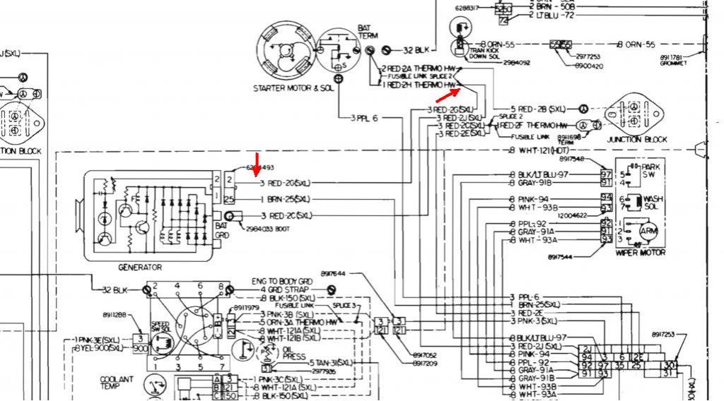

i’ve seen some jump the voltage sensing wire to the battery connection on alternator but is this the best option? is running it to the junction block on firewall a better option?
This is how it was explained to me-
- sensing voltage at the alternator output - seriously hamstrings the system - it's like a self-fulfilling system - it's supposed to maintain 14.0 volts, it outputs 14.0 volts, therefore everything must be OK, right? But it completely ignores voltage drop in the rest of the system - and that's bad for performance
This is where the concept of REMOTE voltage sensing comes into play. Instead of sensing system voltage at the alternator or close to it (which is like congratulating yourself on a great job regardless of the results!) - we sense system voltage where we need full voltage -. That way, when the voltage sensing circuit detects 13.0 volts at the junction block, it says: " I'm supposed to produce and output sufficient to maintain system voltage at 14.0 volts. I sense system voltage as 13.0 volts. Better increase output to 15.0 volts to bring system voltage up to 14.0 volts."
Originally it is spliced to the red wire running from starter and going to light switch. (See attachment.)
Alternatively- I've also seen it ran to the junction block.

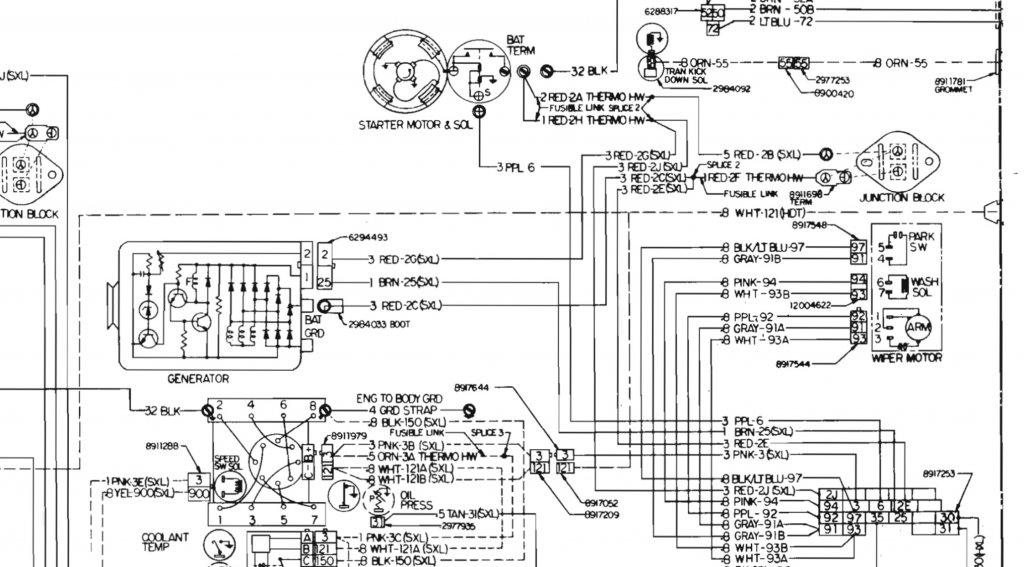

ok. makes more sense now.
so is the sensing wire from the alternator one of the two wires that are joined together on the starter post with the battery wire, correct?
If I’m remembering right (my truck is actually in a workshop out of town and it’s been a couple of weeks since I’ve been able to go out and take a look ), there are two red wires that come through the firewall, one red wire leaves the junction block and goes down to the starter. the other red wire comes from the fuse box and makes a straight run to the starter. those two join up with the battery wire and the sensing wire on the starter.
and the output wire from alternator goes to the junction block as well - in the diagram.
Yes - originally is is spliced to a red wire (at the fusible link) that attaches to you starter with another red wire and black battery wire.
Compare the diagram above when you get to look at your truck.
