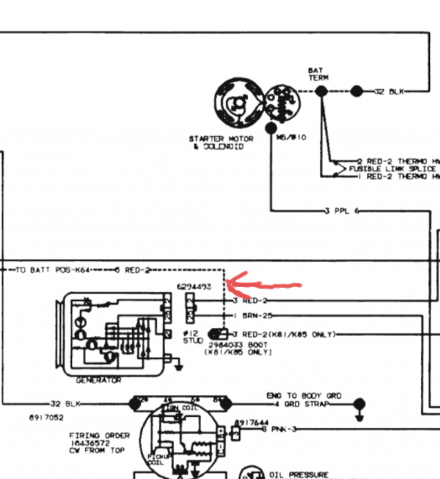

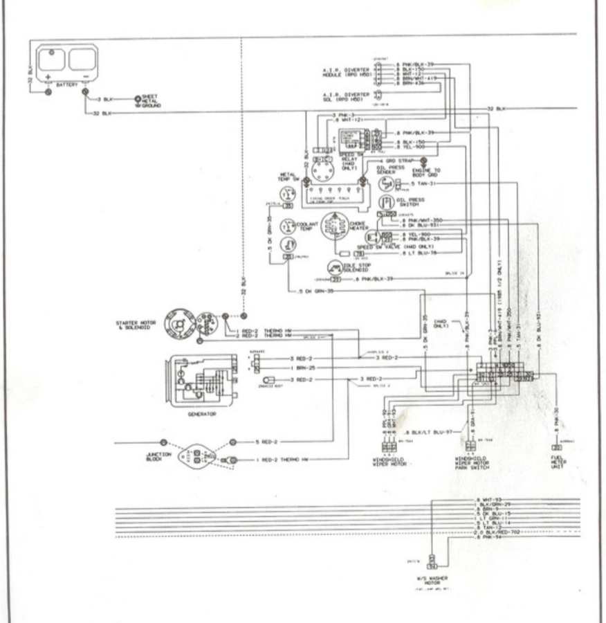

I'm confident my truck is good now, but going to ask this one more time because I'm curious... The wire with the arrow pointing to it was missing on my truck. But the other schematic doesn't show that charge wire going to the battery at all. This was why it was confusing. Which of these is correct for 1986?

I found my answer... The 6 cylinder in 1986 did not have that extra charge wire, but the v8 did have that extra charge wire. Here are the 2 different schematics. I was looking at the 6 cylinder schematic.
81-87 v8 engine schematic
81-87 l6 engine schematic
Things I'll never know... Why someone at some point decided to remove the charge wire that used to go to the battery on mine. Glad I solved part of the mystery.

You have to remember those wiring diagrams were for alternators/generators that came on the vehicle at that time.
notice the rpo codes on the diagram k81/k85 those are 66 amp / 37 amp the k64 means 115 amp
