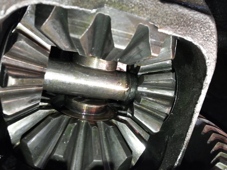

Well yesterday was eventful. Popped the pumpkin open to changle the axle seals due to a drivers side leak. Upon breaking the seal the gear oil looked like a metallic paint. I then started to pull out smallpieces of metal. The guy I bought it from had the rear end rebuilt before I bought it bc he blew it out. The shop he used obviously sucked. I know the shop bc i have fixed their screw ups before on other peoples vehicles... but back to the story. I pulled the retaining bolt and the pin didn't move. So I tapped it and then tapped it harder. Soon I found myself beating the **** out of it and it only moves about 1/2 an inch to either side of the carrier trying to get it out. Upon examination of the pin it is fried and stuck. I will post the pics when i use my pc due to pic size but does anyone have ideas on how to cut it out without a smoke wrench? I will try to rig up a slide hammer on it today to see if that can budge it. But in the end I think a $80 job turned into a $700 job.
