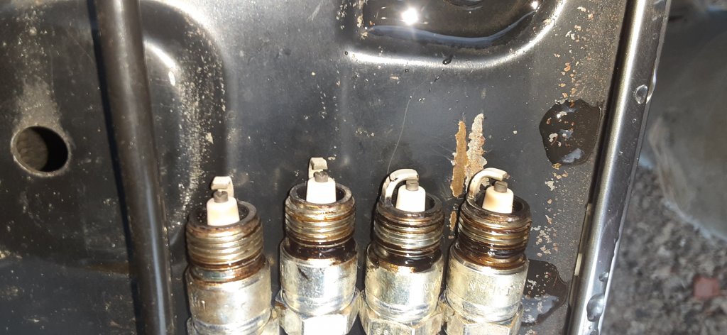

Done this morning. Installed 8 of the CR43TS, and one of the non-fouler things into cylinder #7. This is what I found when I pulled the NGK's out. Keep in mind these are closer to AC Delco 44 or 45 heat range than the 43's the truck calls for.
Below picture: Note #7 is covered in oil deposits after only 300 miles, it did not totally foul out totally but you can see the deposits. #5 has a small amount of deposits and the rest are pretty white, not to bad but I think just a little hotter than she needs.
Below: From left to right, #7, 5, 3, 1

Well, it's a high mileage 305 and as you'd expect I do get a puff of blue at start up. The deposits on the plug are most definitely oil, based on that I assume a one or both of the valve stem seals on #7 are bad. I don't really like the idea of holding heat in, though I understand what you are saying and the reasoning.

As to your question about diagnostic, for oil fouling no not really. I did a compression 3 years ago when I got the truck and without looking in my maintenance book I can't give specifics but it was good at the time. With the mystery intermittent slight mis at idle, which I have been contributing to the oil fouling and anti-fouler I'm thinking another comp test is in order. This is not mentioned in this thread, but my ESC system is non-functional and I've been having pinging issues at timing settings that I think should not be a problem so there is that. Obviously the oil use could be contributing to this, but still it's another notch in the belt of issues and a comp test is in order I'm thinking.
I think, based on my observation that it's a valve guide, as I get a good puff of blue at start up but no other time. However I was thinking about this on my drive to the farm tonight after work. My truck has cat, and it is in good health. I've seen vehicles with cats, where the cat cleaned up the oil burning so much that you really didn't see it in the exhaust, but I don't go though much oil at all. I've never really kept track of it but not more than a couple quarts between changes so maybe a quart every 800 - 1,000 miles. I actually find it hard to believe I could be putting enough oil down one hole to foul it, but never the less it is. I've just been assuming it is mostly all making it out via the valve guides in that one cylinder.
