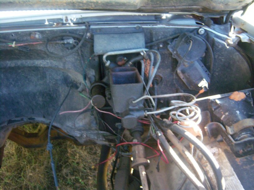

If you want, not sure how quiet you want it, and if you're concerned about what your firewall looks like BUT, you can use Lizard skin, Dyna or Fat or whatever product you want, then you can see about finding the sound deadening panels off of a 6.2 Diesel model from the firewall. The Diesels have plastic with some kind or barrier behind it to keep the noise down. If I don't use my 6.2 Diesel cab, I'll at least be taking this stuff off the truck for one of my others. I like a quiet cab.
Pic of 6.2 Firewall.

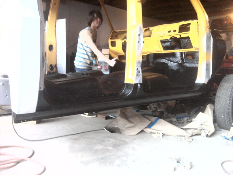

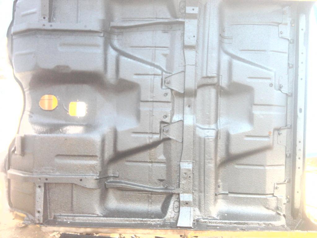

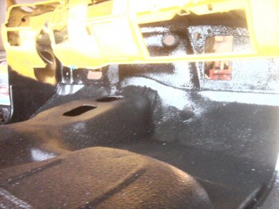

monstaliner diy bed coating sprayed inside and out then dynamat on the firewall and maybe the floor

With proper window seals, that should be one quiet ride.
