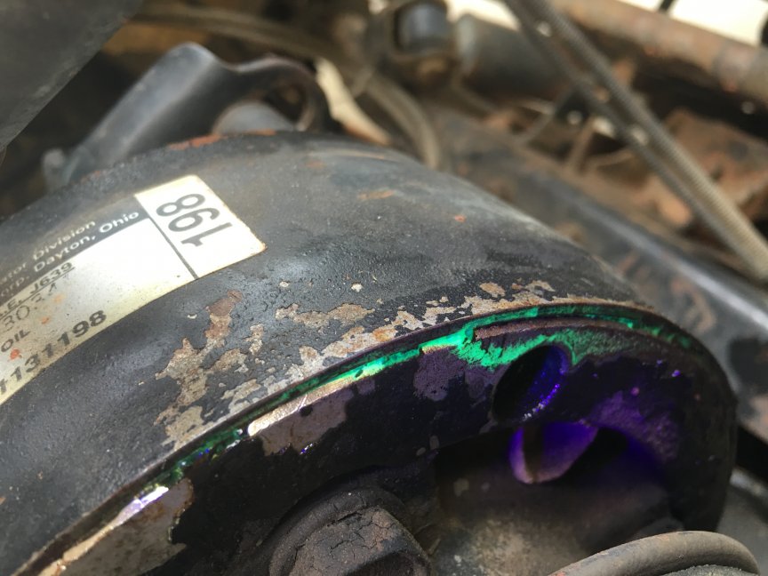

So, getting ready for these brutal Oklahoma summers by replacing all the "consumables" in my A/C system. (gaskets, accumulator, flushing, vacuum for 30 min, etc...) When I was putting my 134 back in and after the expected 5 cans the A/C stopped cycling. Well today the system started cycling again. Thinking that maybe I was just on the threshold last night I went and got another can of 134 and decided to get UV dye in case I had a leak. Well, 5 minutes after getting the can added and letting it run to cycle the dye through the system, I found a leak on the seam of the compressor (picture attached). I'm assuming that this is not repairable but I would prefer if someone could tell me I'm wrong and how to fix this short of replacing the compressor.

Compressor is shot. If you purchased it under warranty, it may be covered. I just replaced my compressor, accumulator, and orfice tube in order to get a lifetime warranty. You should still be on record if purchased at an auto parts supply store, if not you will have to buy a replacement compressor. They retail at Autozone for $250, accumulator tank... $25 and orfice tube $6 ( all should be replaced at the same time since the oil and atmospheric oxygen leave contaminants in the system once opened).

There is no warranty on it at all. I bought my truck for $500 knowing it had a bad heater, (ended up being the heater core was vapor locked and ended up fixing it myself by running it with the cap off and "burping" it by squeezing the hoses) a bad transmission (cost me $1300 to get it rebuilt, installed and warrantied), and no A/C. I replaced the accumulator, flushed it, vacuumed it, and added freon. I didn't replace the oriface tube though. I'll do it this time around when I replace the compressor. (just need to figure out where it is.) Question though, can i get an A6 compressor or does it need to be the pancake compressor that is in it now? I couldnt see how the A6 would hook up but online it says it is compatible with my truck.
