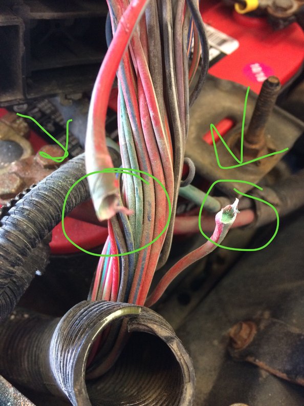

I had to help a buddy track down an electrical problem in his JEEP that has been giving him fits for 2 years-finally all of his climate control motor door operations and blower motor quit working. I traced it all the way to a faulty (it was technically an open circuit since there was a major corrosion blockage) so there was voltage at the fuse panel but not at the blower relay on that same wire-it was a severely corroded wire under his fuse panel underhood. Here's how I do "field" repairs with regards to soldering....pics are in order-this is the best way to do it imo.....enjoy:

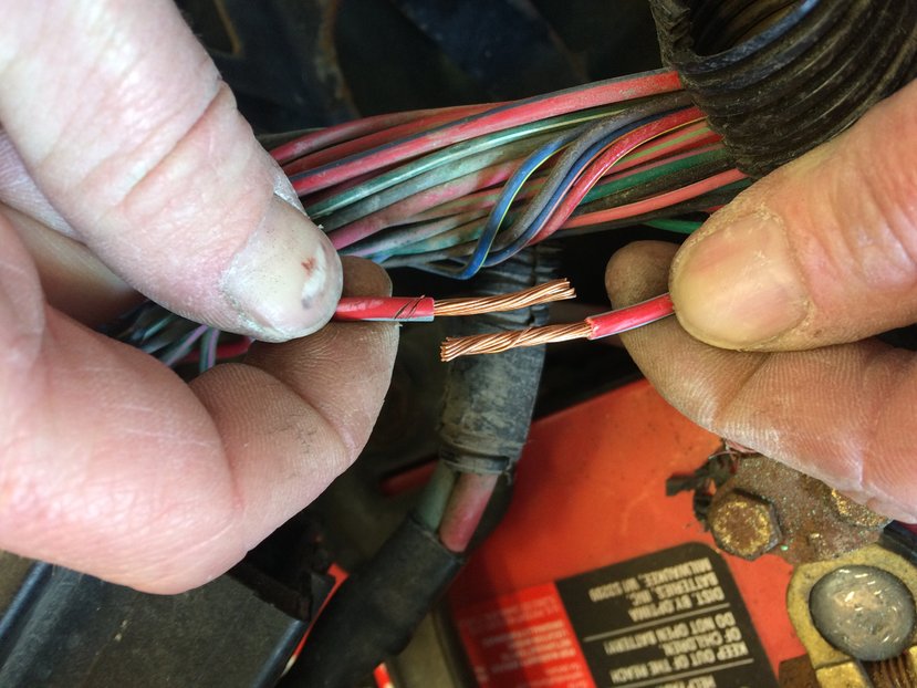

If room allows strip back about an inch of good wire strands on both ends-elimination the corroded section....slide a piece of dual wall polyolephin heatshrink on the longest lead like so...

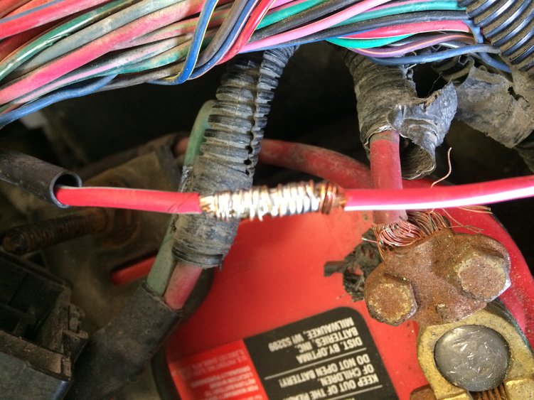

We will solder these two ends together like so.....

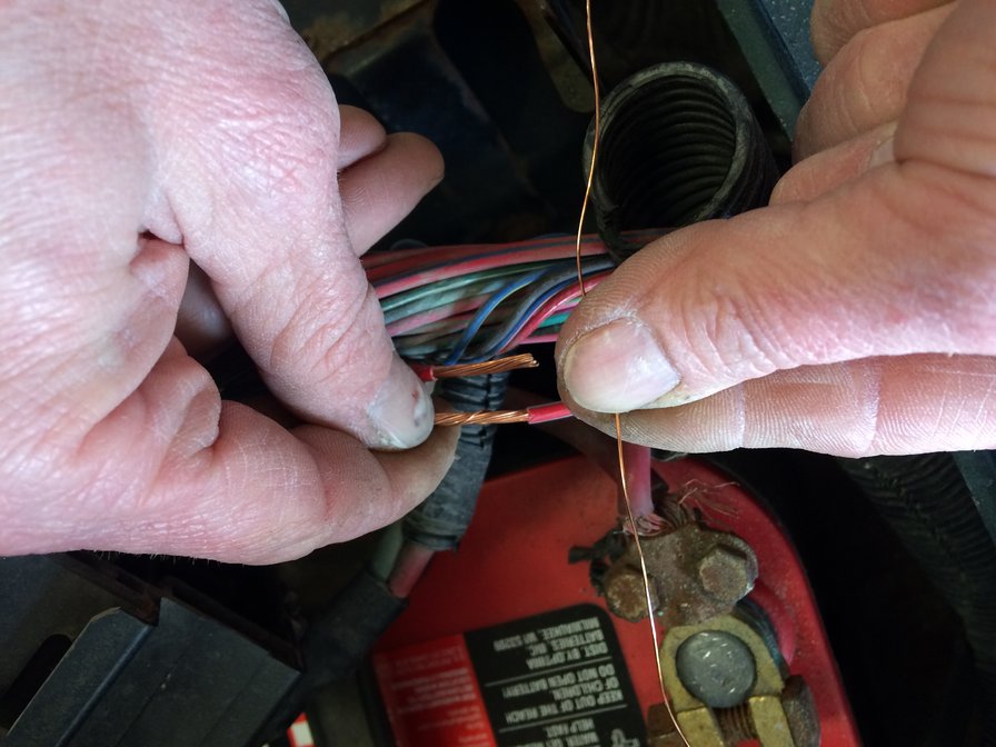

I use strands of 10ga wire to act as a tie wrap to tightly bound the repair section together-I stock 6-inch lengths just for this purpose....

After soldering it should look something like this....

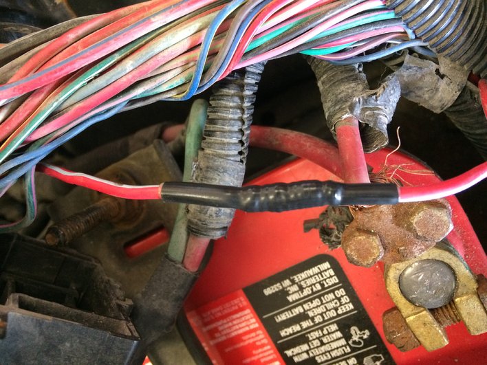

After sliding the tubing over and slowly heating it the gel starts to ooze out the ends to seal it and that's it-repair done!
I like that, never seen it. On the LS harness, I've been using what he's using below, but with longer strips of wire. Push the 2 sprawls together, then twist one end clockwise and the other end counter-clockwise. If you do it tight enough, the wires will hold each other together.
