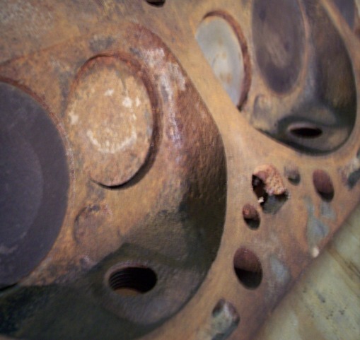

Probably had burnt exhaust valves on those cylinders, or depending on the year of the truck, maybe it has recessed valves from running unleaded fuel on a leaded head. Some people say that is a myth and it doesn't happen. I am here to tell you, it happens. I have a set of heads that it happened to. Every single exhaust valve was recessed at least an 1/8 inch and some up to a 1/4 inch. I am not even sure those heads can be saved with a new set of hardened valve seats the valves were recessed so deep, and I am amazed it didn't drop a valve. It would have, had the recess got any deeper and allowed the valve stem to come up higher and lose the valve keepers.
47,859
11,038
I found the pic of those recessed valves. This was taken after the heads had laid out in the yard a few months, but you can still clearly see how the exhaust valves were recessing and eating away at the valve seats.

wow never seen that before. Mine weren't sunk or sucked in, but might have been warped or burnt or something. I had to have them redone. it happened after it got hot once and blew the upper hose off, it wasn't in a truck then, but was built for a truck and is in a truck now lol. I noticed it smoking a little on start up and revs sometimes, mostly start up and went to put seals in it, wouldn't hold air pressure on no. 2, can't remember if we tried 4 or not, but we had started on that side.
47,859
11,038
This one was still running too, it just had a slight miss that I could never get rid of, and seemed to lack power. I knew the motor couldn't have had many miles on it, so I did a compression test and 2 cylinders on one bank we like 45 lbs differant, so I decided to pull that head, and thats what I found. Then the pulled the other head, and same thing. So when someone tells you, you don't need hardened exhaust seats in an older leaded head to burn unleaded fuel, you can tell them they are full of **** that you seen pics of it happening. If it were just one valve, I'd suspect something else, but no, it was all 8 exhaust valves did this, just that a couple were worse than others. In that photo, its actually not showing the worst 2, I just wanted a pic of 2 valves together in the same shot. I'm wanting to say valves on cyl #1 and #8 were the worst, and probably why I noticed the miss since firing order is 1 then 8, 2 weak cylinders right in a row of the firing order.
