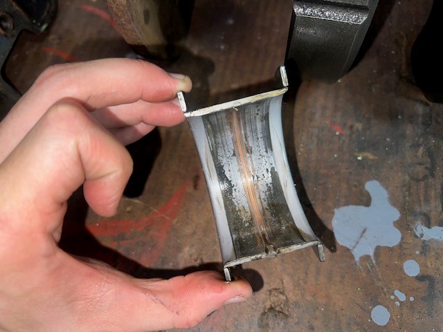

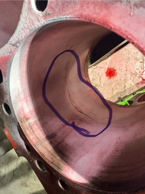

UPDATE: Option 1 is FUBAR. See pics. Crank has been cut .010 already and is scored again. 3 cylinders are cracked. I magna-fluxed them and, well, you can see the result.

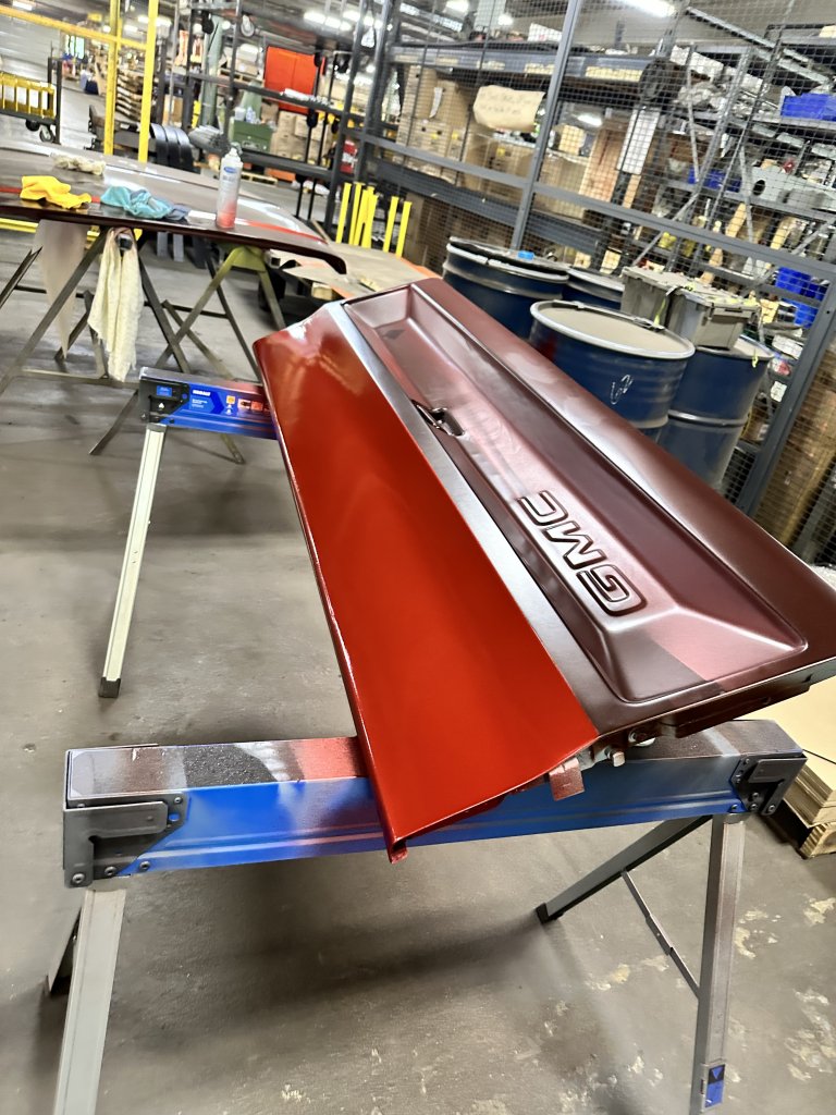

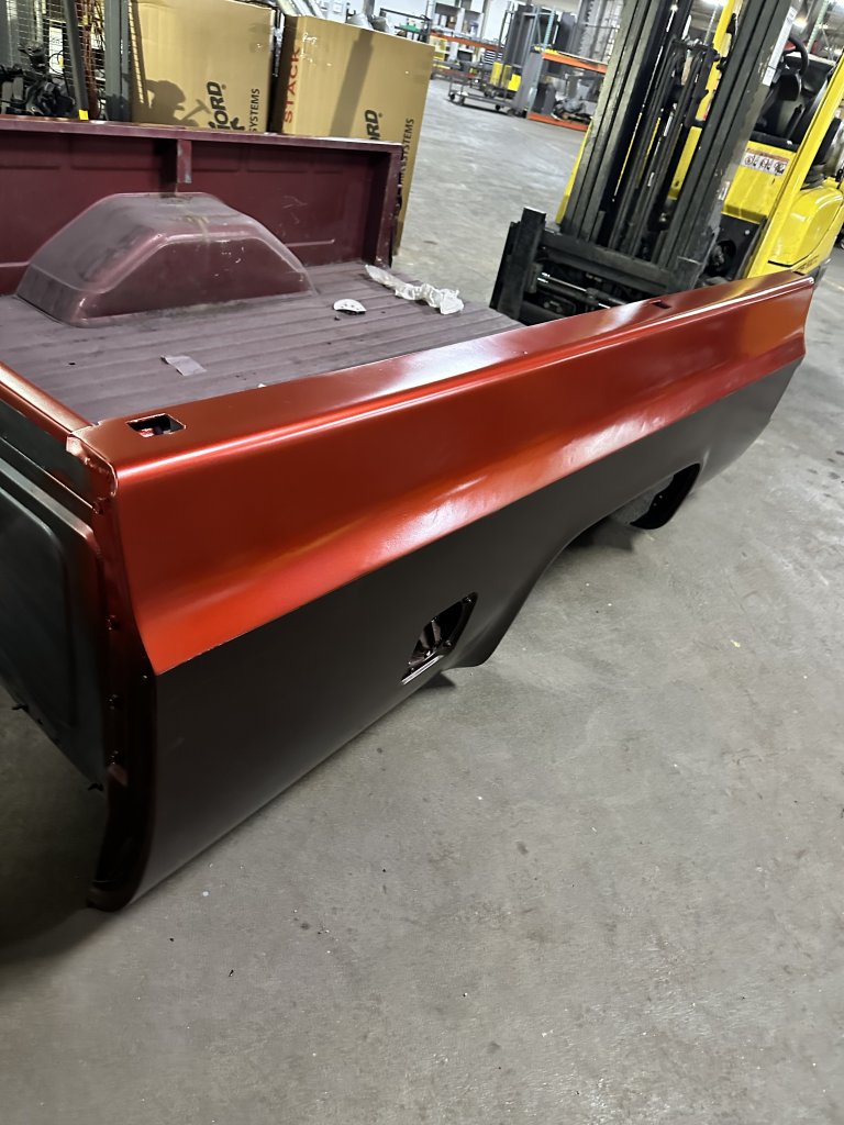

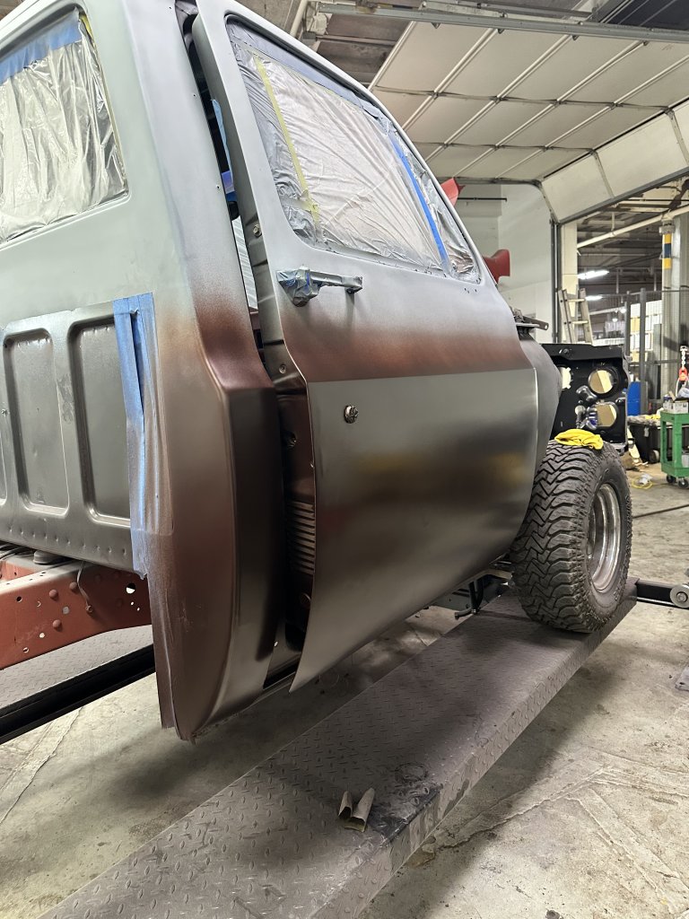

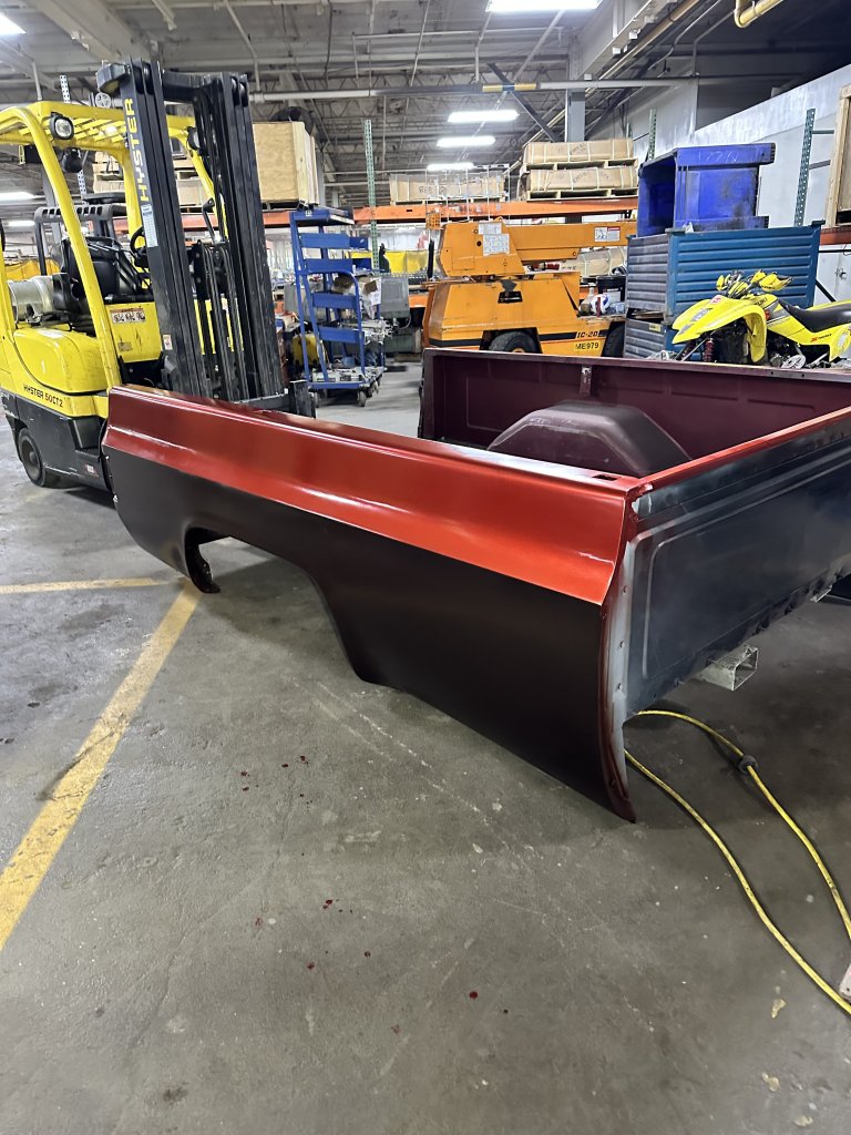

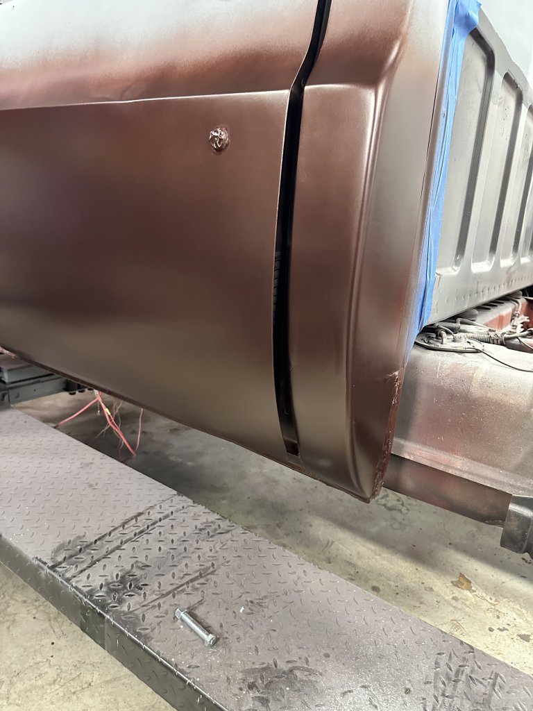

#3 block and the 64cc heads it is. Block and heads headed to the machine shop Monday. There's .050 piston to deck clearance which is too much. not going all the way to zero deck but probably .o10 to .015. Hardened valve seats and threaded studs and a valve job. I'll port the heads on intake and exhaust side once I settle on my intake manifold and headers. Meanwhile the bodywork and painting is almost done.

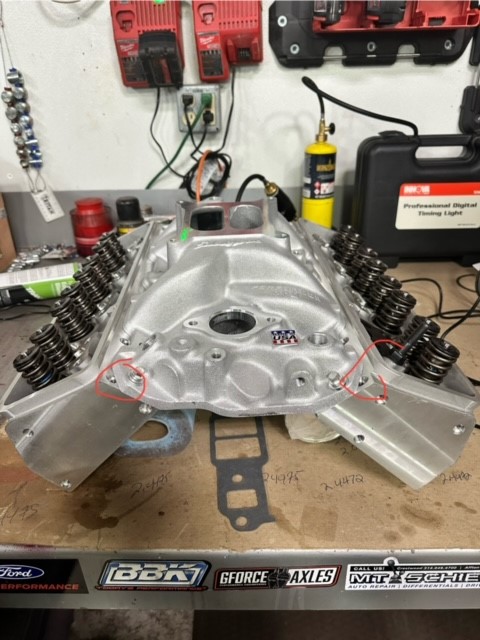

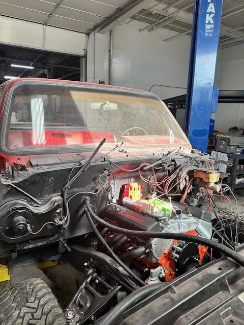

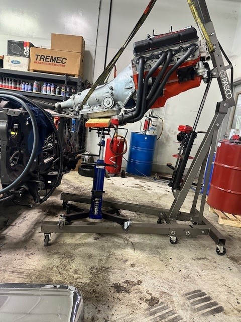

Update: of the 3 blocks I had, two were cracked. That made the selection simple. Ended up .030 over, 400 crank, 6" rods, 64CC new style aluminum heads with 2.02 intake valves, Erson cam, hydraulic roller tappets, KB Hyper coated pistons, Edelbrock performer RPM intake, Holley Brawler... Final result is a 383 stroked small block.
