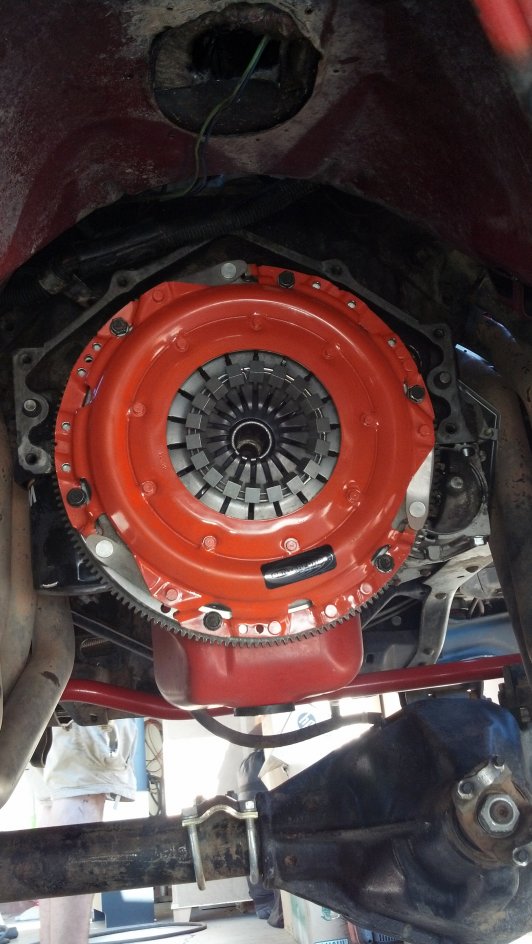

Heres the clutch it put in it

Damn, that's nice looking. I see now on those fingers. There in steps. I can see how that can be a variable type feel, or lots of holding power without a major heavy foot. 11in or 12in?

12" ya it feels lighter then the crappy orielys one I had on it before. Just need it to not leak everywhere now....

So it feels lighter, but has more holding power. You'll like that clutch if you ever get some big power behind it.

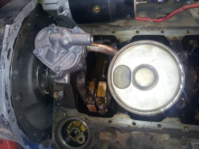

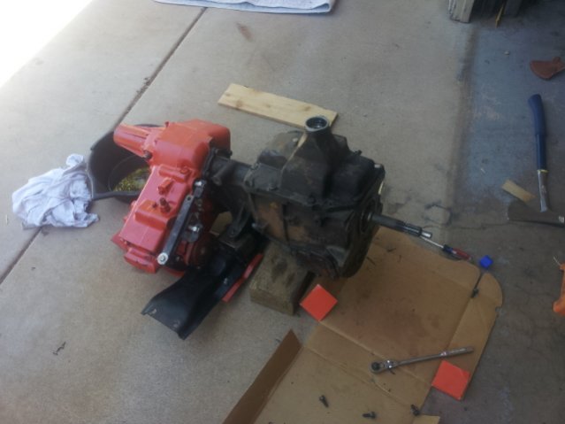

Got it back in left it all together tcase trans. Got trans sealed up. We did rear main to but fuggers still leakin the crank is kinda pitted up so may never get it to stop. Just hope some mud does the trick. Put a new oil pump in it to now its runnin 40psi witch is better then the 20 or so it was before.
