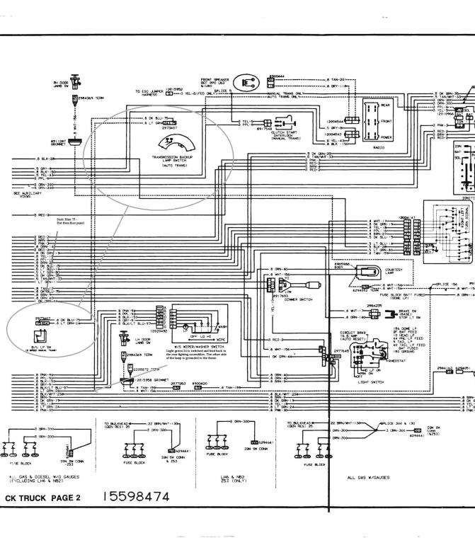

If you know the switch is good it's easy enough to check whether the plunger on the switch is closing the contacts. Just put the shifter in reverse and check continuity across the switch.

Light Sensors
The SM465 used an integrated back-up light switch that received its input directly from the transmission internals instead of from the shifter or shift rails -- which the top-loader doesn't have -- like most other transmissions. The sensor plugs into the side of the transmission, near the back where you'd expect the reverse gear to be.
Identification
Some later versions of this transmission also used an integrated neutral safety switch, which cuts power to the starter whenever the transmission is in gear. This safety switch is very similar to the reverse-light switch, but located closer to the front of the transmission. If you see two sets of sensor wires protruding from the transmission, the reverse-light switch is the one closest to the driveshaft or transfer case.
Failure
Reverse light switches can fail in a number of ways, but failure generally begins as an intermittent event and quickly goes total. The reverse light circuit is fairly simple; power goes from the fuse box, through the switch and directly to the back-up lamps. Check the back-up bulb first, then the fuse and finally the connections before attempting to replace the reverse light switch. The reverse light switch can be very difficult to remove on trucks without a removable transmission tunnel, since the switch needs about three inches of clearance to slide out of the transmission. You might consider cutting a small access port in your transmission tunnel, then riveting a piece of sheet-metal over the hole to ease installation and future servicing.
