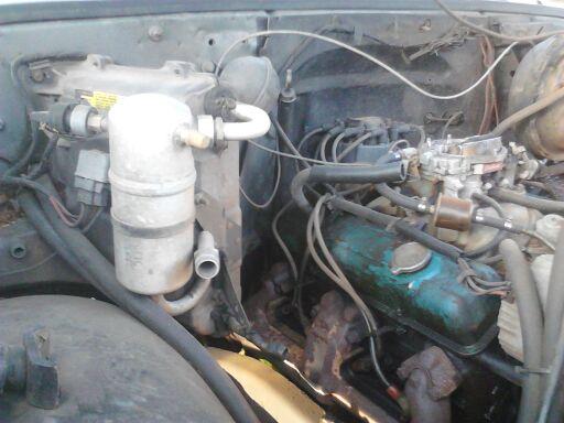

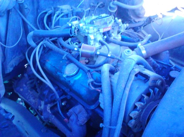

So i just bought a '79 with a known cracked (and JB welded) block. Supposedly it's holding but that won't do in the long run.
Vortec 350s are popping up cheap, and dressed (i need a compressor anyway) and i'm wondering...
It appears, based on other postings, that the exhaust manifolds should bolt up so we're good there.
I understand I'll need a $200 edelbrock intake manifold to convert the FI to carb (good, new, Edelbrock carb, i think, on the truck currently - hope that will swap over)
The alternator isn't a problem, just a pinout to solve.
So that leaves, i think 4 questions:
1)Bellhousing - Will the Vortec bolt right up to my TH350 with the existing TC?
2)Motor Mounts - Do i need anything goofy?
3)AC Compressor - I will just assume that GM changed fittings somehwere between 1979 and the Vortec era - can a hose shop just make those hoses up for me reasonably?
4)Ignition - the big one - Do/Can the Vortecs run distributors or MUST i run some sort of ECU for spark?
OK, a 5th (of Turkey, pleasse)
5)Any specific years to look for that make any of the above easier or harder?
My hope, of course, would be to find a $300 dressed engine and find out that i can just drop an intake on it and everything else will bolt up, and deal with the AC lines when it gets warmer.
What say the experts?

Assuming you are talking about the gen1 vortec (96-2000) everything will bolt up once you have the Vortec specific manifold.
Carb, electric fuel pump, Distributor....and make sure you use 96 or newer listings for spark plugs.....vortec specific. As far as accessories, you can re use all the 79 v belt stuff, make sure you use the 79 water pump.
