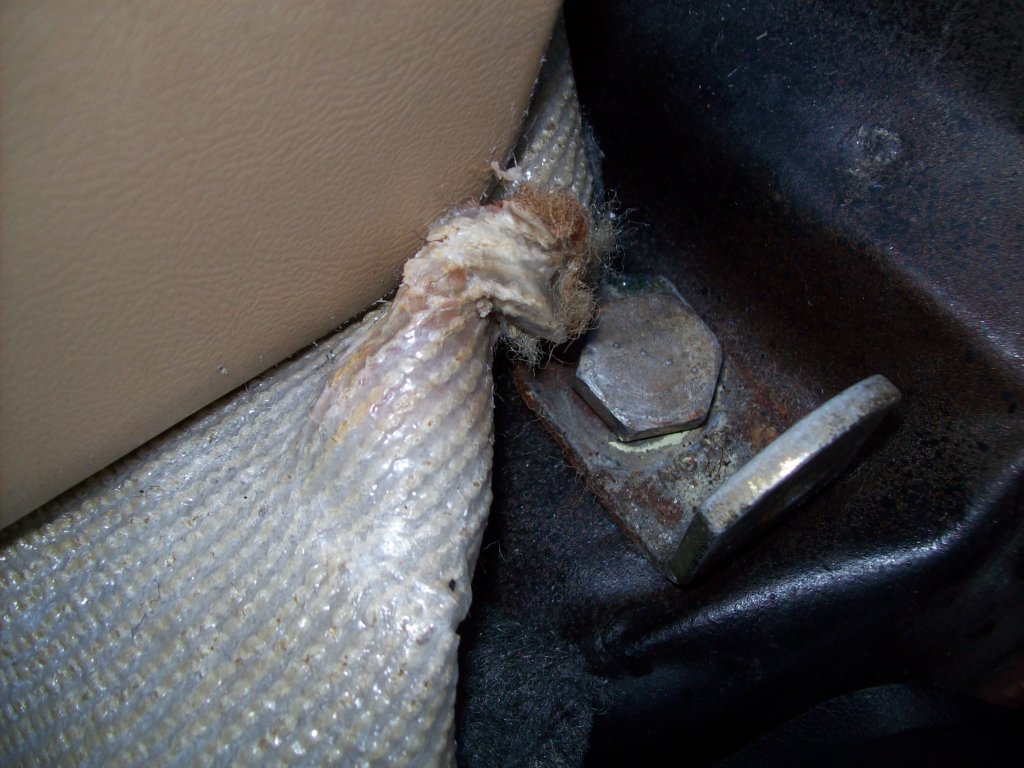

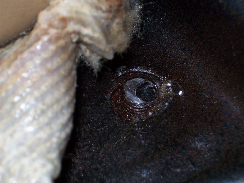

Replying to an old-ish thread:
I just sheared off the head on the bolt holding the driver side seatbelt to the floor. (I was trying to replace the seatbelts w. aftermarket). Applied liquid wrench, drilled a hole, tried easy-out reverse thread thing, no joy it is STUCK. Really do not want to have to drop the fuel tank to address this issue.
Seems to me my options are:
1. Try to heat the remaining bit of stuck bolt and hope the easy-out can move it
2. Take it to a shop of some kind and have someone weld a nut on the end of that stuck bolt, maybe also with heat can remove
Re. option 1: heat, this whole thing sits on top of the driver's side gas tank, any real concerns using a torch inside the cab heating the bolt considering the tank is 8" away?
Re. option 2: a welding shop, think a muffler shop might deal with something like this? They must deal with crappy nuts, bolts, and welding all the time. Else what type of shop should I look for, general automotive or something else?
Thanks!

You want to heat the metal nut around the bolt so it expands… the trick is heating it quick before the heat transfers to the bolt itself. Have an impact/socket or long breaker bar ready.
That broken one needed to be drilled in the center.. grind a broken bolt off flat before center punching. You can still use a die grinder with the proper cutter, try not to destroy the threads of the nut.
