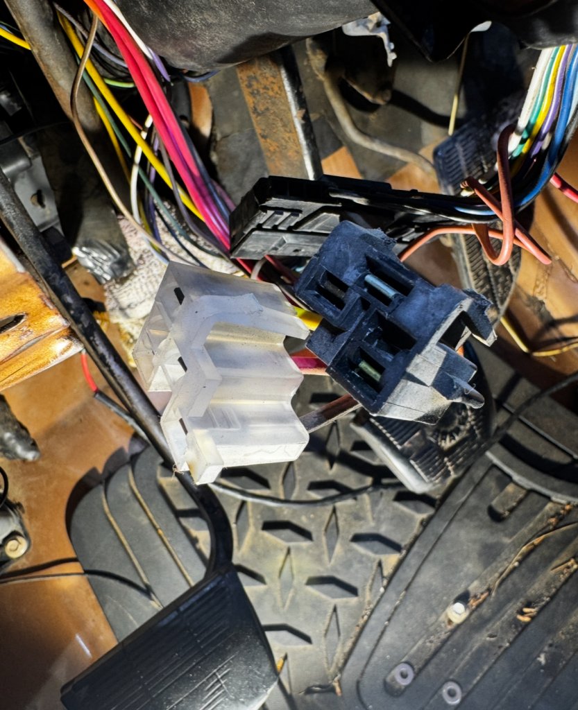

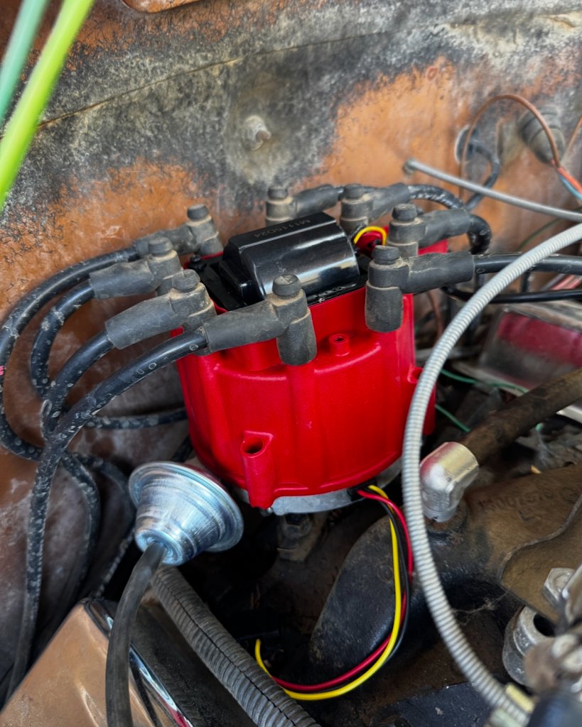

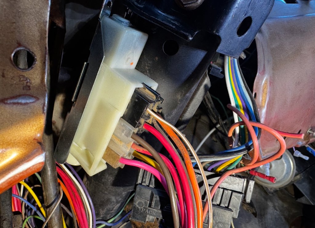

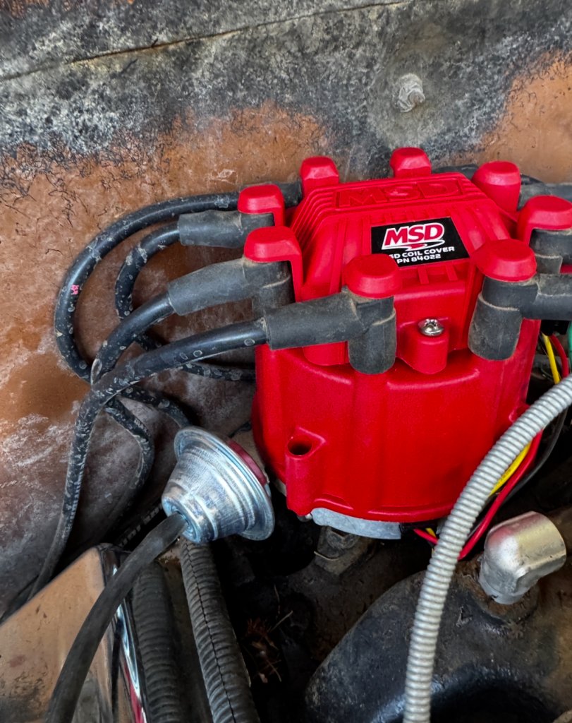

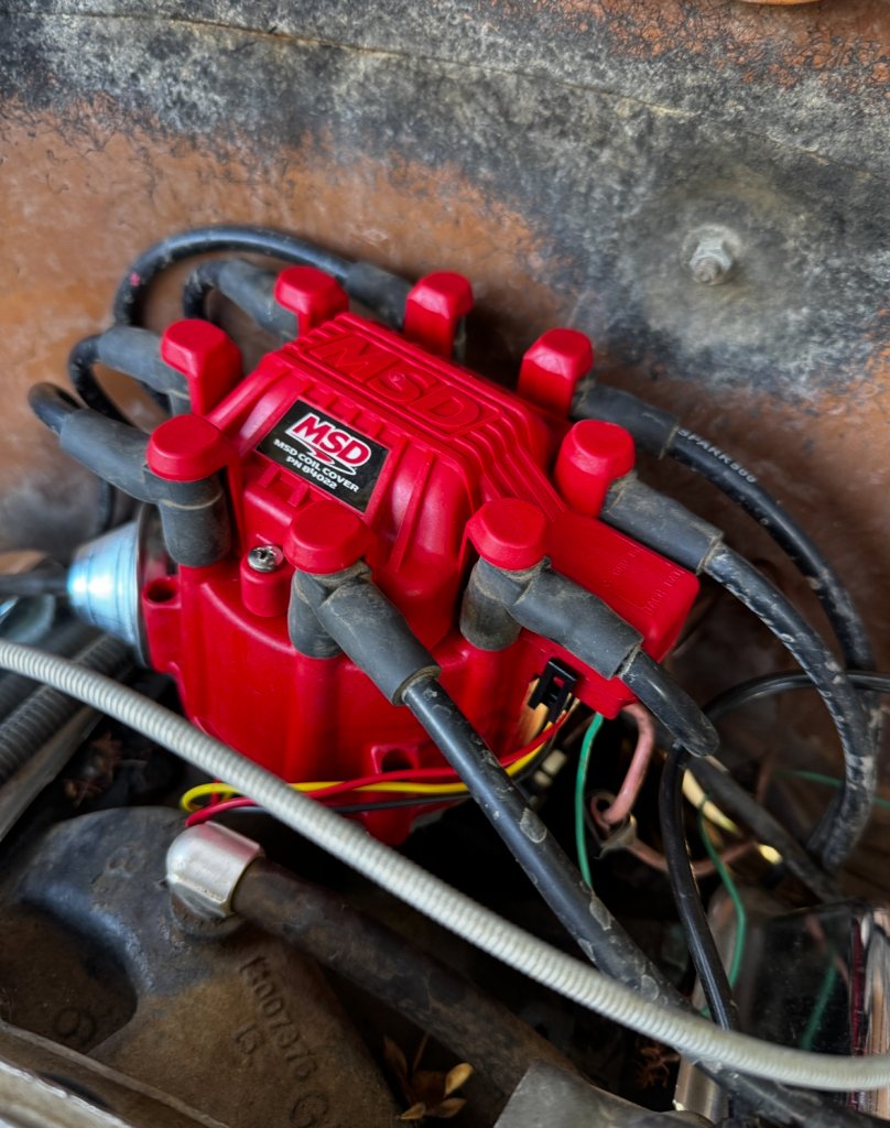

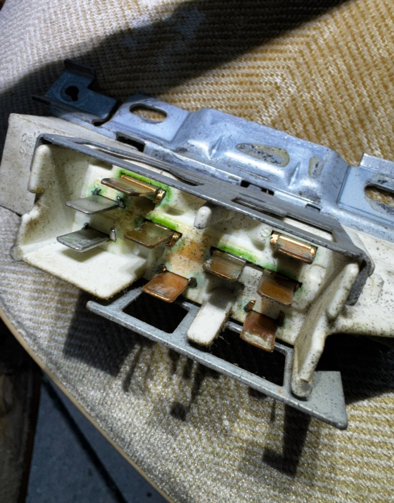

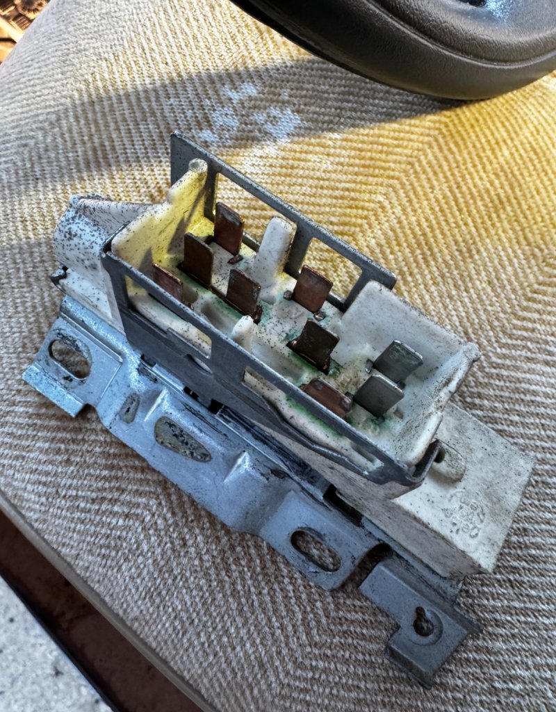

Does it die like you turned the key off and run fine the rest of the time (except for the one big backfire)?
If so that suggests an electrical short somewhere on the ignition side that is killing the spark.
Gotta do some real time diagnosis.
When it dies, see if it’s getting spark.
Takes 2 people unless you can pull a wire and pop in a spare spark plug and ground it somewhere visible while cranking.
Could be the actual ignition switch, a wire shorting out (although I feel that would be more intermittent) or anything not replaced with the distributor.
