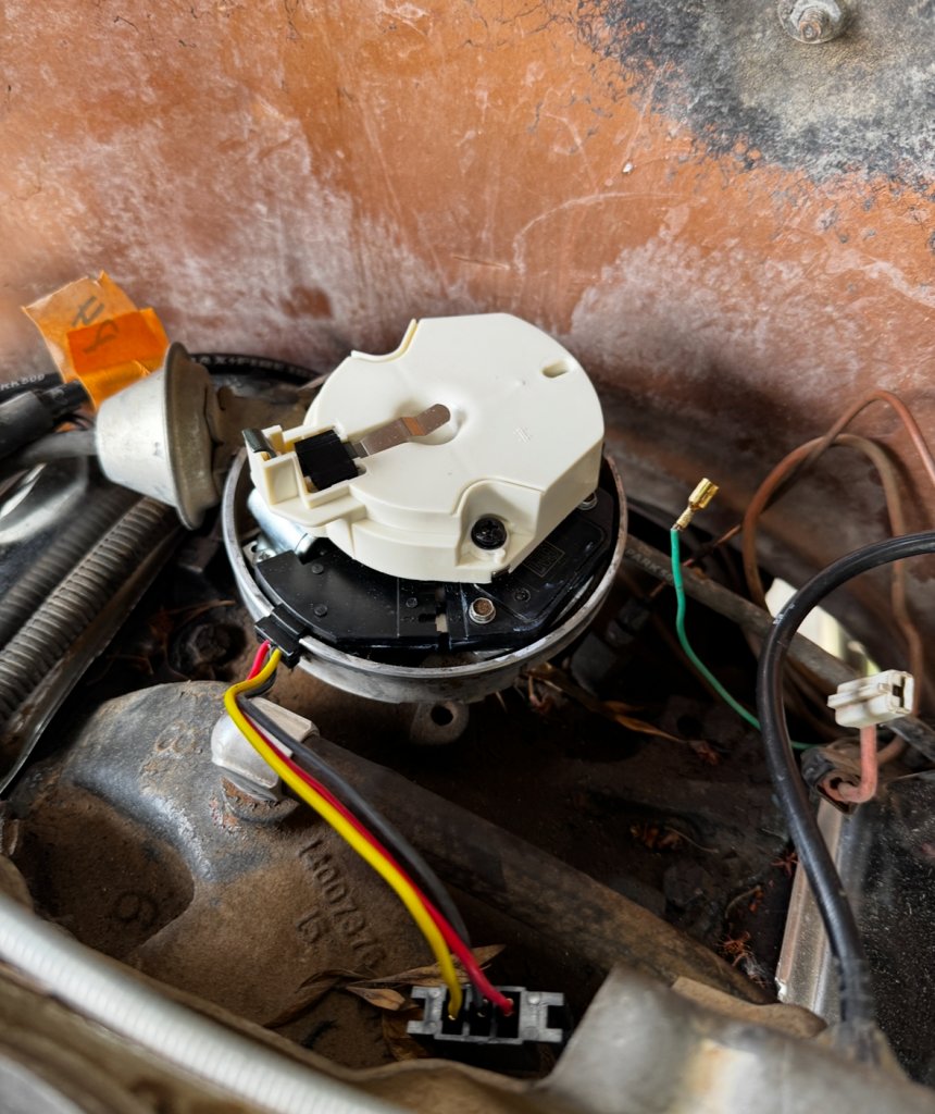

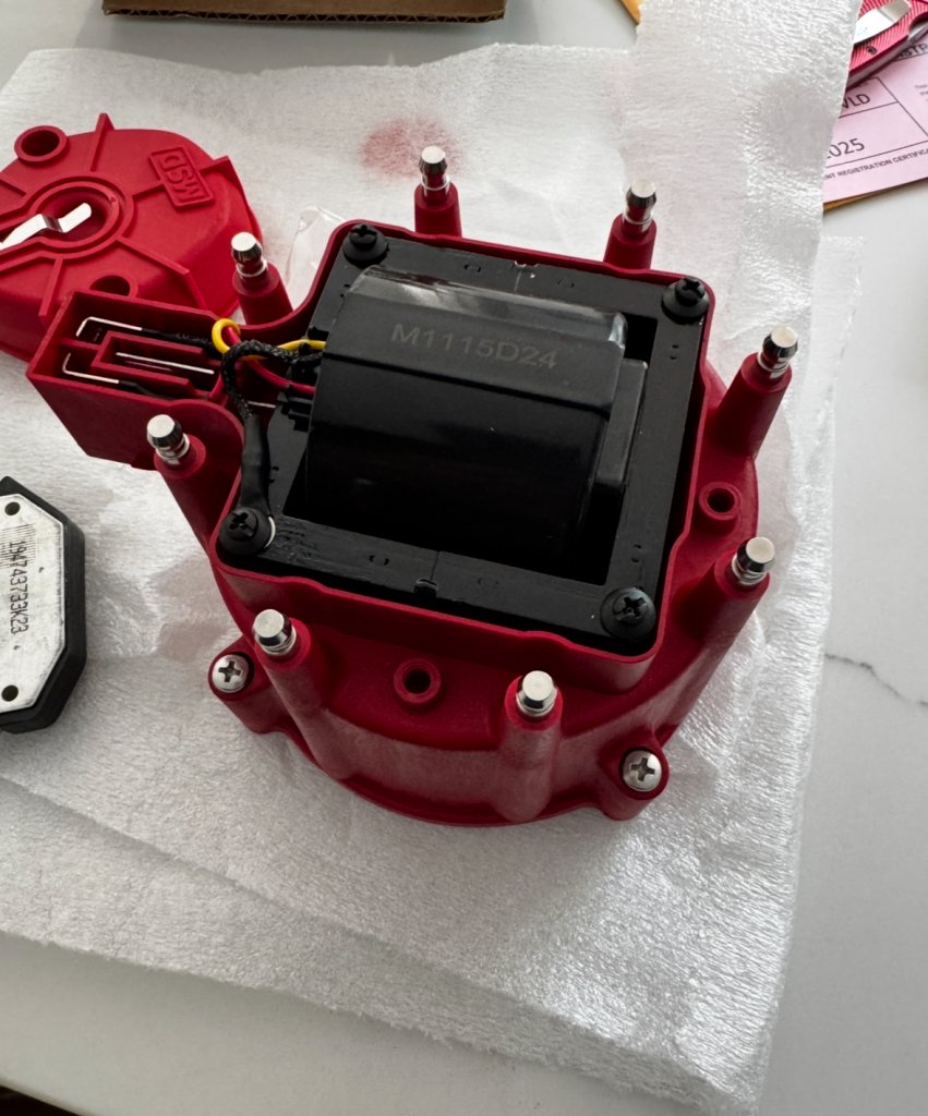

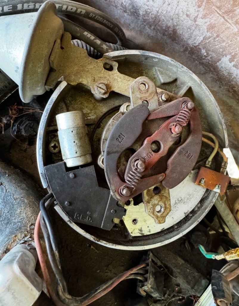

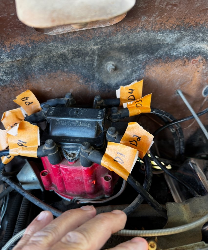

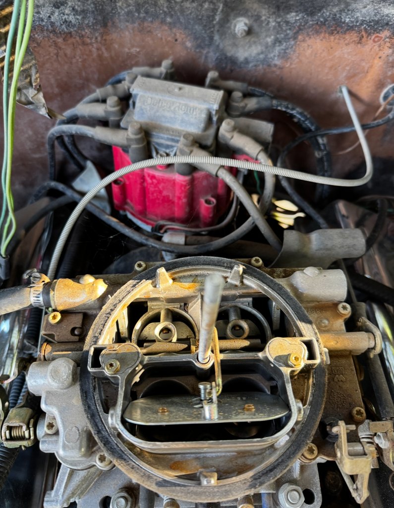

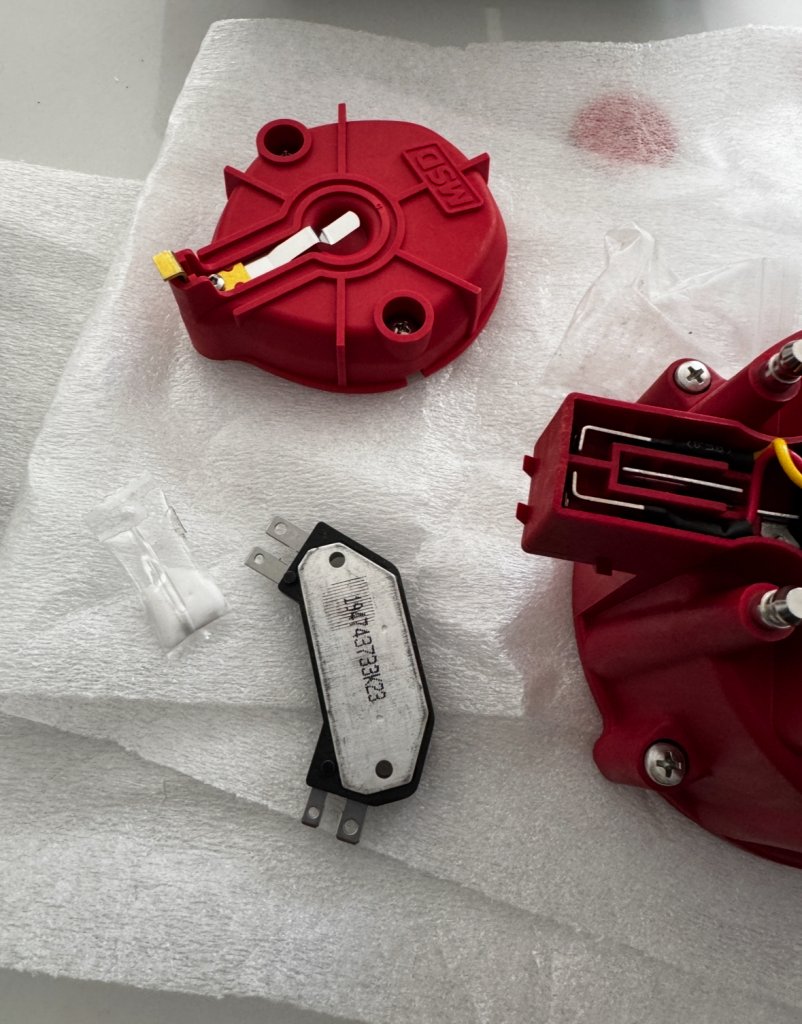

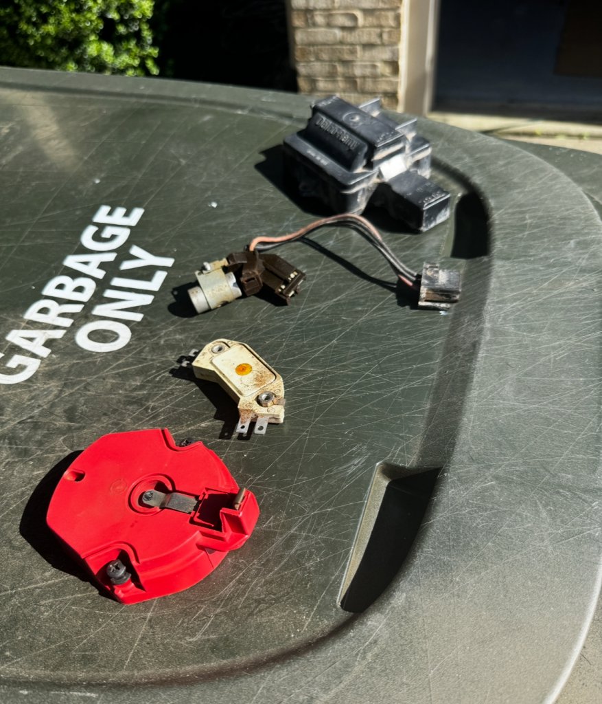

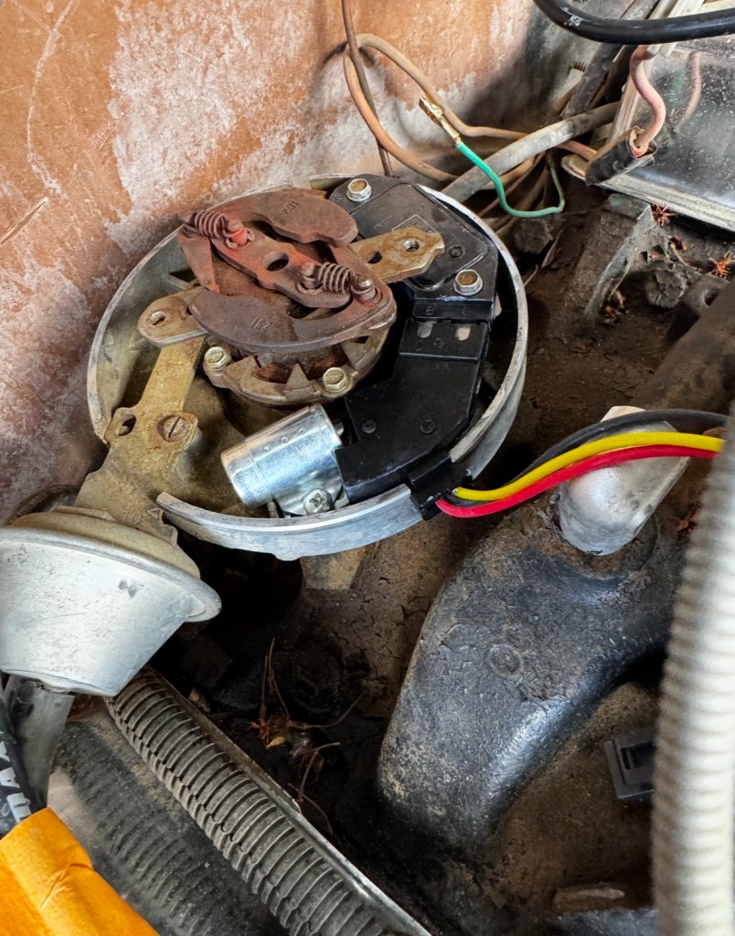

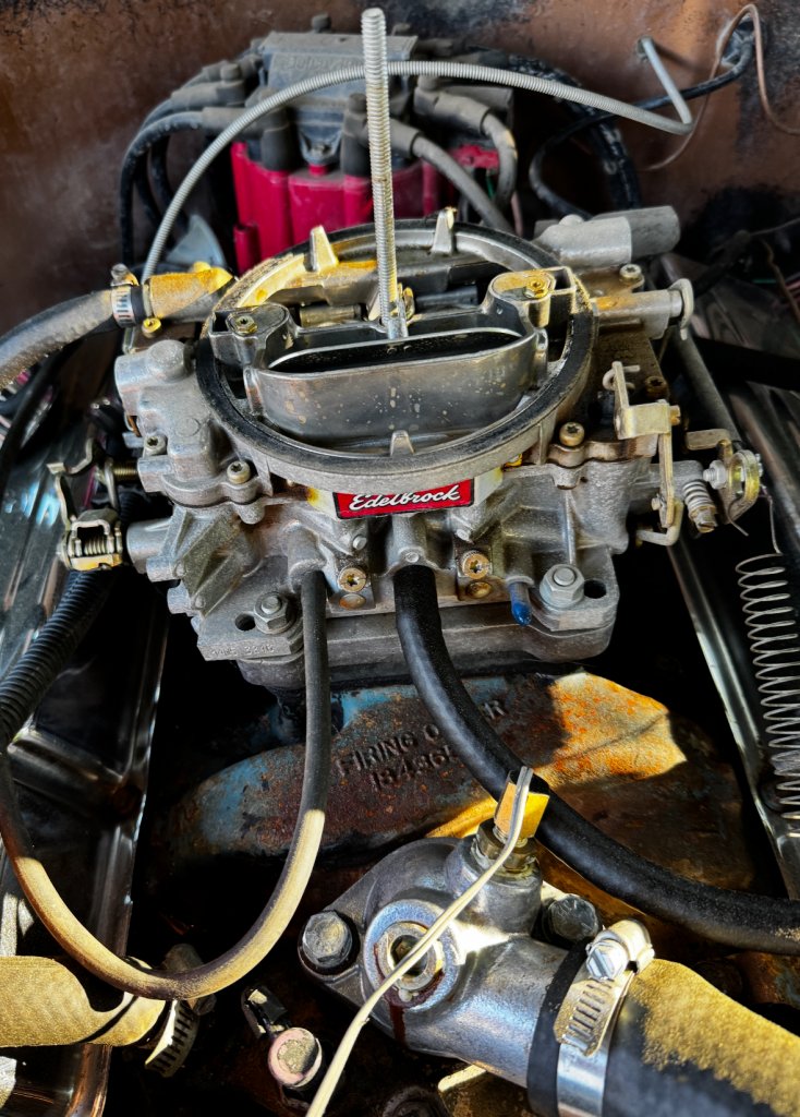

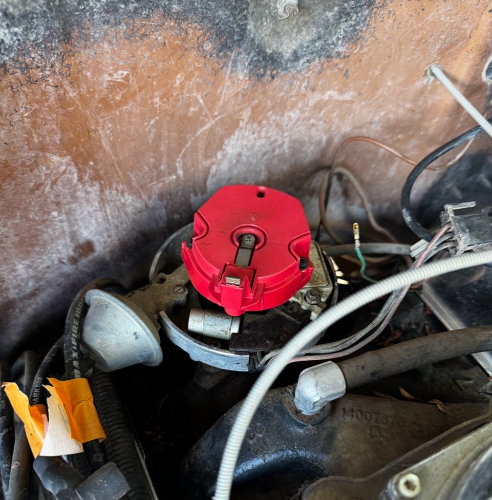

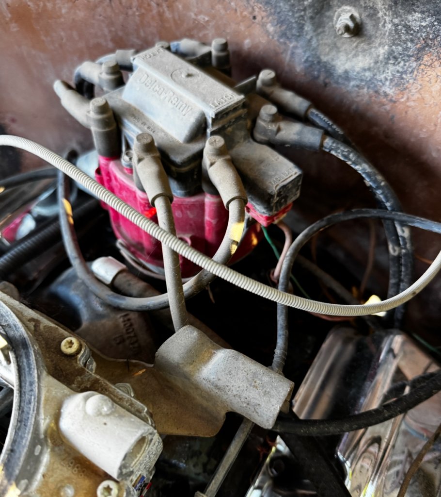

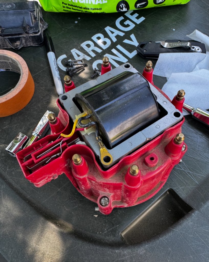

So, thank you all for your advice and guidance throughout this process. When I returned yesterday, all the parts I had ordered had already arrived. As recommended, I ordered and replaced the Ignition Coil, Ignition Module, Distributor Cap, and Rotor. I messed up the Radio Capacitor during the replacement, so I bought and replaced that as well. I put it all back together and took it for a test drive. It was a perfect run for the first 15 to 20 minutes, which seemed better than ever. I was pulling into the store, and it stalled again. I got it going, and when I pulled onto the highway, it stalled again. I popped the clutch and got it going again, and this happened two more times. Long story short, I got it home, but something is clearly wrong. As you all may remember, I have a new fuel pump, but I didn’t install it since we didn’t think that would be the issue. So I can replace that, and I think I might. (Trying to carpet bomb this thing.) Other than that I truly am at a loss. Any additional advice would be greatly appriciated. I am thinking at this point I might just need to put an EFI system in. Thanks as always. I’ll attach some pics of the work I did today.

Did you put the heat resistant grease (stuff in the little clear package) on the metal base of the new module? Also, that vacuum advance looks awful crusty; I would see if it works or not.
I will definitely replace that tomorrow looks like it is only a $25.00 part
Sorry also forgot to answer Yes I definetly used the grease packet on the back of the module.
