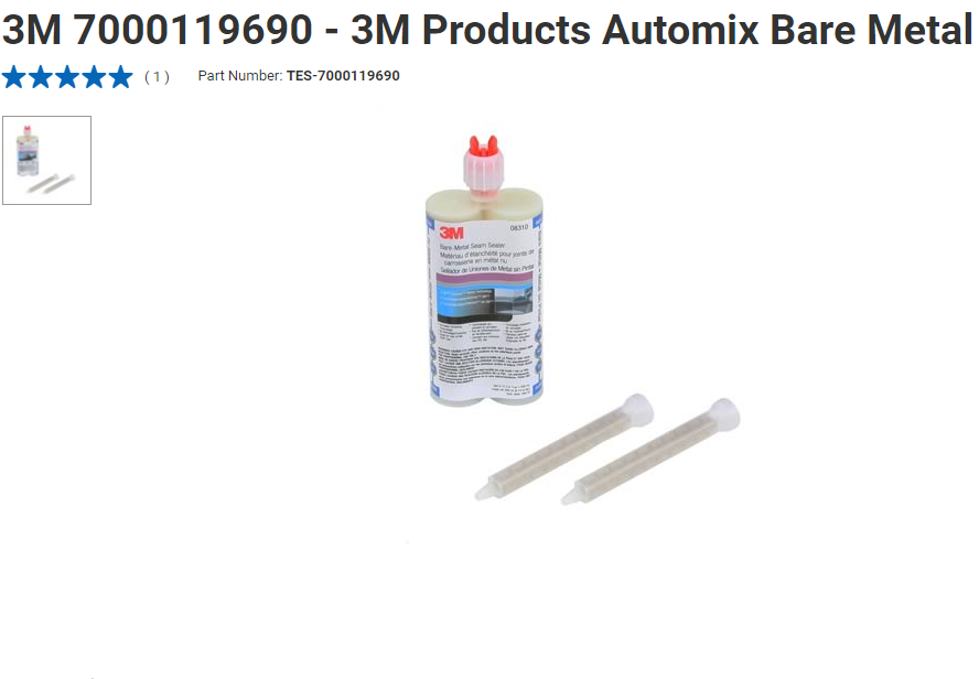

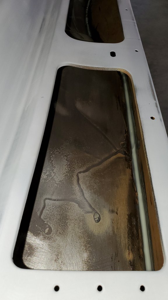

I used 3M also and it came out awesome. unfortunately you'll also need a gun.

It says bare metal but if you look it up it can be applied to primer also. and 15 minute cure time to paint
9,433
17,291
I believe any urethane seam sealer will adhere to about any clean surface.
I just did the seam on top of a shiny chrome step bumper. Even the smallest amount was tough to peel off.
I used a razor knife to scrape a little off the chrome bumper surface. It wouldn’t peel.
Bed was done with Delco and bumper with Dynatron
