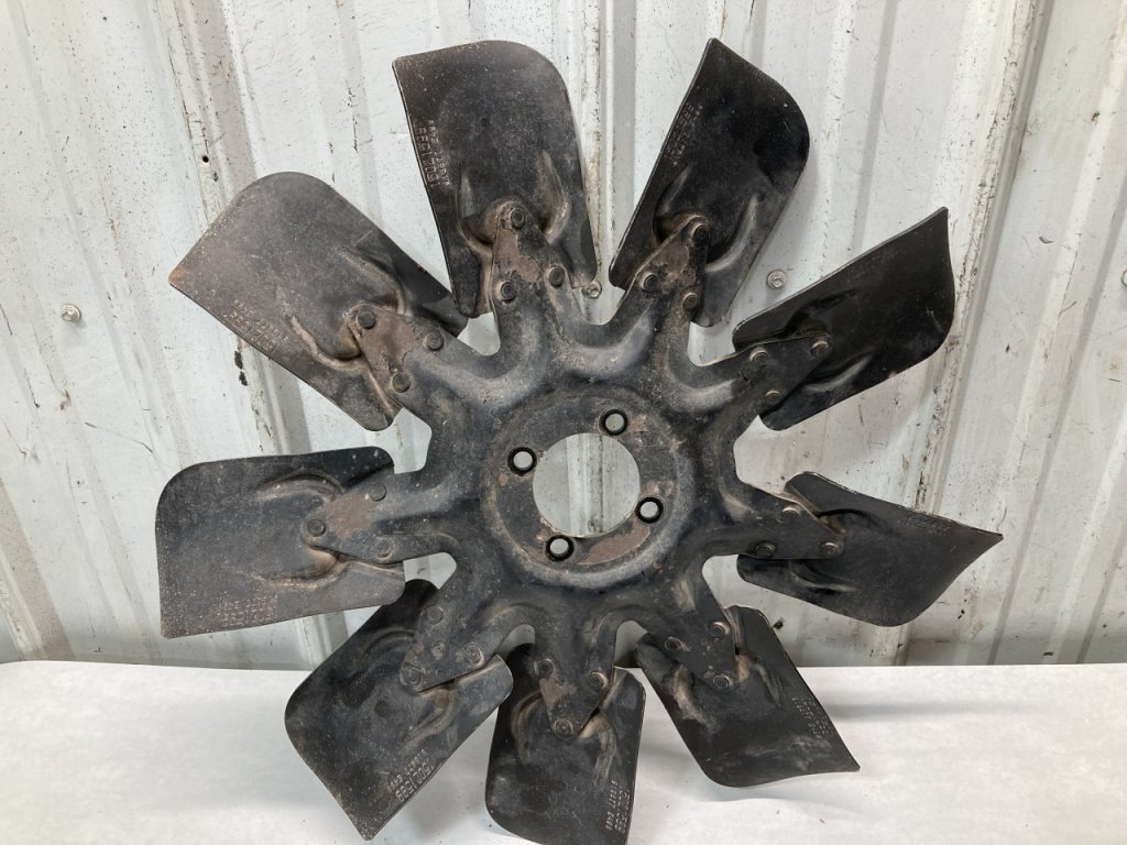

OEM Cooling systems seem to be designed to run right on the edge of overheating. The thermostat opens all the way, and then what ever happens happens. Go up hill, haul a load, turn on the A/C and the engine overheats? That seems lame.
I had shroud problems on my rig. I wound up getting a clutch fan with more blades, and then used a spacer to get it much closer to the radiator. Then I closed off the space between the core support and the frame using a sheet of thick plastic because a LOT of air was being drawn through this area by the fan, which would be bypassing the radiator. After that I put a chrome 3/4 shroud on there (mounts easily to any radiator with plastic "zip tie" like things), but I mounted it very close to the fan (its flexible, so you can change the diameter). The closer the better, as long as it doesn't hit the fan when the engine flexes its muscles.
So the only area of the fan that is not shrouded is about 5 inches or so on the bottom left and bottom right. I have some chrome material to finish wrapping the shroud around all the way to fill that 5" gap, but I decided not to, because of the lack of need. With this setup, my thermostat is regulating the temperature more than anything else. Cooling system is efficient enough that the fan clutch never comes close to fully engaging, and the engine temp never rises at all above where the thermostat will allow it to even when its 90 degrees out, and I'm pushing the motor hard.
Using a thermal temp gun helped a lot, to see what difference the changes made.
So ya, I recommend just building your own setup.
Thermal gun: $14
Spacer: $12
Chrome Shroud $39
Fan (junk yard) $15
(Google pics)
