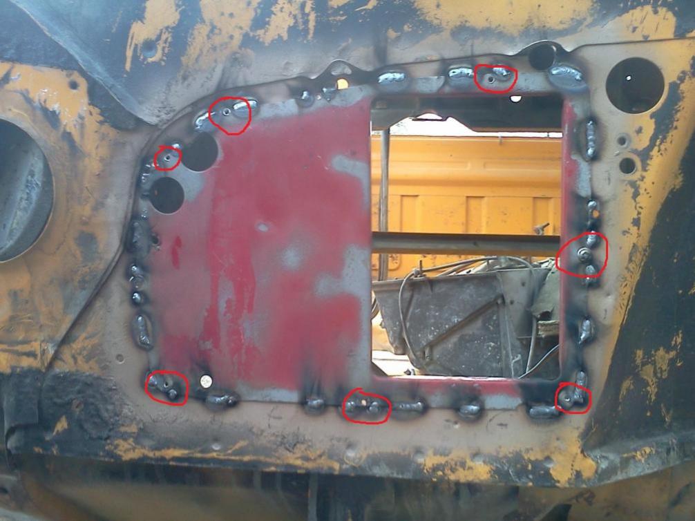

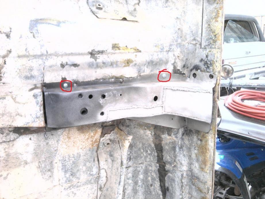

use braces to keep the cab straight
i use self tapping screws to hold the rockers and repair pannels in place before welding like the screws that hold the wheel well trim on you can buy them at hardware stores
you can see how i used the screws in the pics i circled them in red
you can just remove them after welding then weld the holes up.
the screws help hold things together to make sure its lined up before welding and to hold it in place for welding

The screws are a great idea if you are over lapping the metal being welded but if you want to butt weld in the panels then you are going to need butt weld clamps.
http://compare.ebay.com/like/350458498873?var=lv&ltyp=AllFixedPriceItemTypes&var=sbar
I would overlap the floor pan patches but butt weld the outer rockers and cab corners. This will give you less area to have to use filler on. Make sure you use some weld thru primer and seam sealer on the overlap welds to help fight corrosion.
