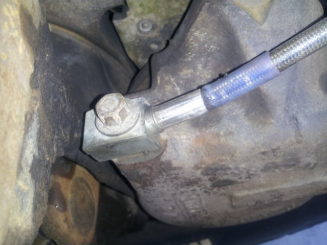

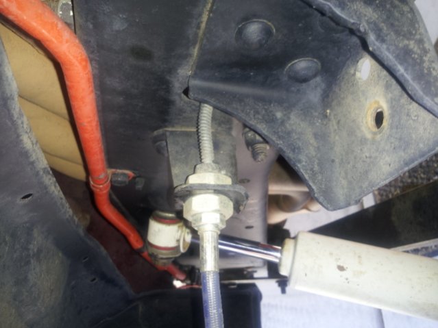

I have them on my truck. The different ends are what matters for the size of the banjo bolts on the caliper like 10mm or 7/16. Those sizes might be wrong but thats what you need to looke at. This is how they mount up on frame .on the stock ones theres a clip on back. these bolt to bracket. Theres washers on the caliper side that seal the fitting.

I had called Russell(edlebrock) and spoke with them and they said the only difference is about an extra inch on each hose in one of the kits. My fitting ends aren't squared up like yours. Mine are rounded. I guess mine are newer models or maybe older ones. Thank you for the response by the way. How was the fit ment? Did you notice any difference in braking? Was it worth all the work to do this? Thank you again
