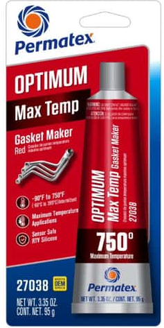

If the bolts snap off, you may be able to "glue" the plate on with the high temp gasket sealer.

Thanks for the idea. Yeah, last thing I want to do at this time is
be removing the intake manifold. Really, would like to drop in
an 8 popper... Just so maybe I could think of passing on the dotted yllw.
Those slow pokes!.
Have you used the high temp gasket maker in similar
desparate situations?
Geeze, what are the chances of both bolts breakin'.
(I promise to be car*full):banghead:
Those slow pokes!.

If the bolts break,which they probably will if this is an aluminum manifold,NBD drill a pilot hole,drill that hole tap drill size,and tap the holes,very common. You said you are going to use heat,good idea,and penetrant,probably a waste of time on an aluminum manifold beacause galvanic bond is the problem,but it doesn’t hurt to try, one last thing smack the heads of the bolts a couple of times with a drift and a hammer to help break the bond loose. If that doesn't work I have another trick up my sleeve. Post back and tag me if necessary, it's more involved but will still be mechanically fastened and a lot more sure bet than hoping something stays glued under heat and exhaust pressure.
