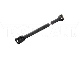

It is high quality, not a cheesy china POS.
Guy I know that has a drive shaft shop in Ca does alot of race car/boat and polished aluminum show car drive shafts and he wanted $400+ just to replace the slip yoke and spline and one u-joint on new slip yoke and balance. Rebuilding the double cardan would be more $$
So this Dorman shaft was a good deal
....PS Oops , spoke to soon, see below :mad::insane::mexsmoke:o_O

Damn this Dorman is 2 1/2" diameter tube. My original shaft is 2" and Rock Auto Dorman description says its a 2" also. Part number on box is correct but its a 2 1/2 " shaft
Anybody running a 2 1/2" shaft on a turbo 400 auto square body
Im going to go take other measurement, bolt pattern, other diameters

Nope , frickin Cardon CV is 4" diameter, My original is 3 1/2" diameter. The Dorman will not clear the cross member for the trans mount. Too Big :insane:
Original shaft tube is 2" dia , Dorman is 2 1/2" dia
PS
Dormans specs say 2" diameter. I got 2 1/2" and the cardan CV is larger too
Maybe its package wrong... My box dorman sticker 938-192 part number is correct on the box

It may not fit the particular application due to the larger size, but it does indeed look to be a quality unit.
True , quality, But its all over size and wont fit

Not pic of mine , same though. Compare 2" with 3 1/2" Cardan and 2 1/2" with larger 4" Cardan. The double Cardan u-joints are larger also

I called the number on the Tech support card that came with the Dorman Drive shaft.
PowerTrain Industries makes the drive shaft for Rock auto.
PowerTrain tech guy says they dont catalog/make a front drive shaft for 87 and older chevy 4x4 . The 938-192 driveshaft is for 1988 and newer chevy. So Dorman is Cataloging the '88 and newer drive shaft for 87 and older chevys

My slip yoke is worn bad
Spline shaft of the slip yoke need to be cut off on a lathe and weld new spline onto the shaft tube and then balance. Job for a drive shaft shop. Sure the rest i can do my self
I found a drive shaft shop in Ogden Utah that will build me a complete all new, proper 2" dia drive shaft with a stronger full spline slip yoke, and ship it to me in Idaho at a good price
