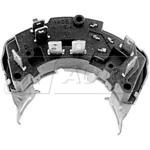

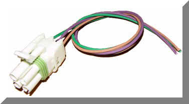

it'll look like this this is the neutral and backup light safety switch and the 4pin connector for trans
First Pic of of the N P Safety Switch, the next 4 prong pigtail goes to the 700r4 and if for Converter lockup and has nothing to do with BU lights.

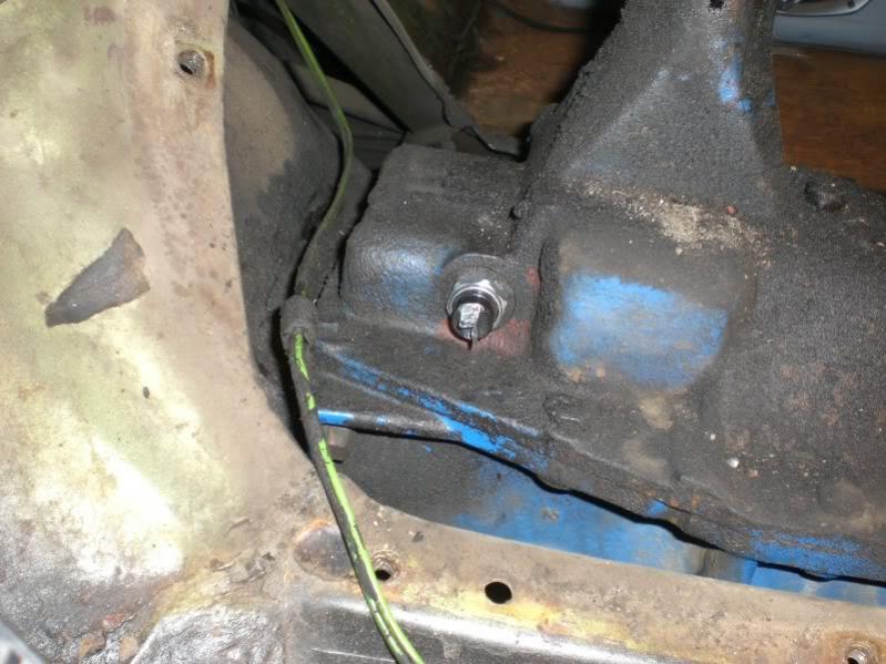

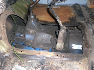

anyway if it an SM465 here the switch should be, found these on google i personally dont own any standards but i have worked on these before
