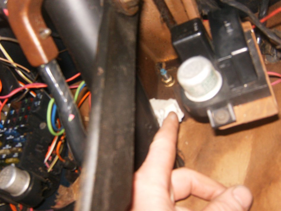

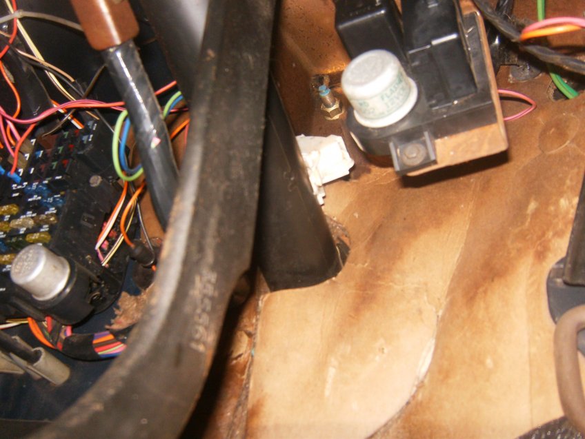

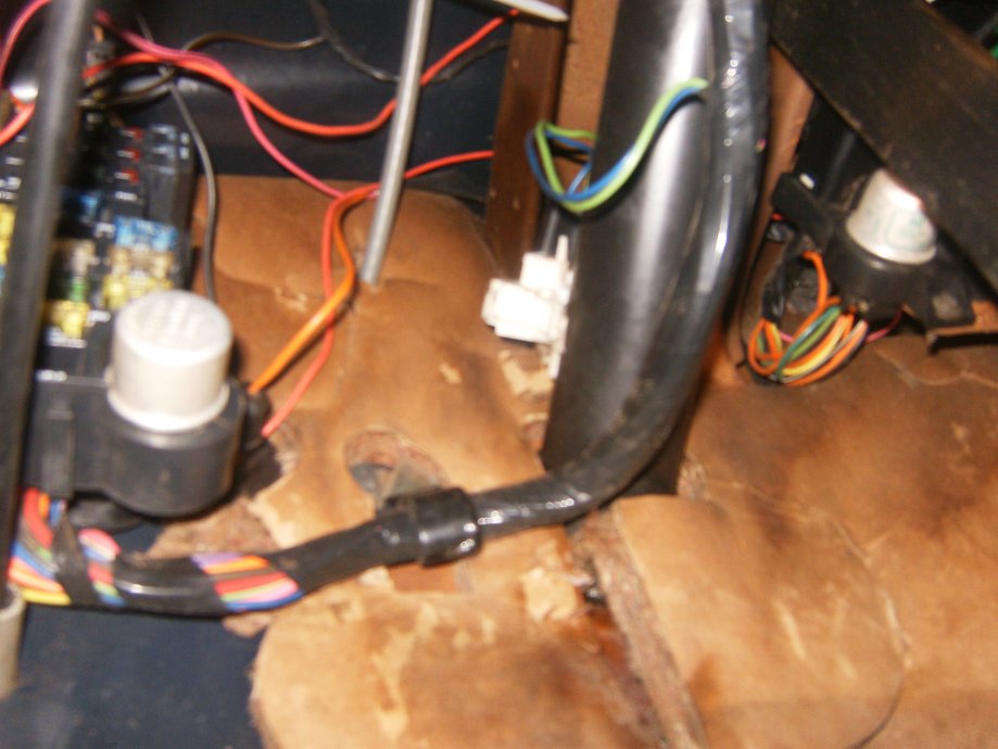

I am guessing that since you can get the lights to come on, by lifting up on the gear shift lever, that you have a neutral safety/back-up light switch. It should be column mounted and right up against the firewall. Correct?
At one point a few years ago I was having the same trouble as you. It was not really an issue - until you have to keep upward pressure on the shift lever while trying to back down a steep dark driveway in the middle of the woods.
So I decided to at least look at the switch. Often that's as far as I get.
This time however, I fixed it. Took about 2 minutes and zero dollars.
While I was poking at one side with my finger, the whole switch made a ratcheting sound and rotated around the steering column. Seems that the plastic housing (switch open/close point) is infinitely adjustable.
It might take awhile to figure out but basically put your gear shift in R and then (with the key on) have someone watch the back-up lights. Push the switch one way or the other - I forget - until the back-ups come on.
Here are a couple of real bad images I just took - I am reassembling my steering wheel/horn button so I was in the area. My finger tip is pushing on the RH (passenger) side in one of the photos:

Probably needs just a very minimull movement to get it corrected. Go too far and You`ll be lifting on the shift lever to get it to start.
That was the problem I was having with My 79. it took a bit but I finally got it right.

man this should be a sticky , I am glad you posted this ??? and I am extremely grateful for the pictures and the solution. I have had this same problem for the last 6 months since I bought my square , after this I just now went outside in the dark and fixed it in exactly 2 minutes and it starts to . thanks .
rscustomrods
Jun 12, 2012
52
Arizona
Rich
Damn Chengny! There you go again making my day! I have been fighting that thing all weekend and ordered a new neutral safety switch. Now I don't need it but it was only ten bucks. Thanks again! Love this site. I second the sticky:)
