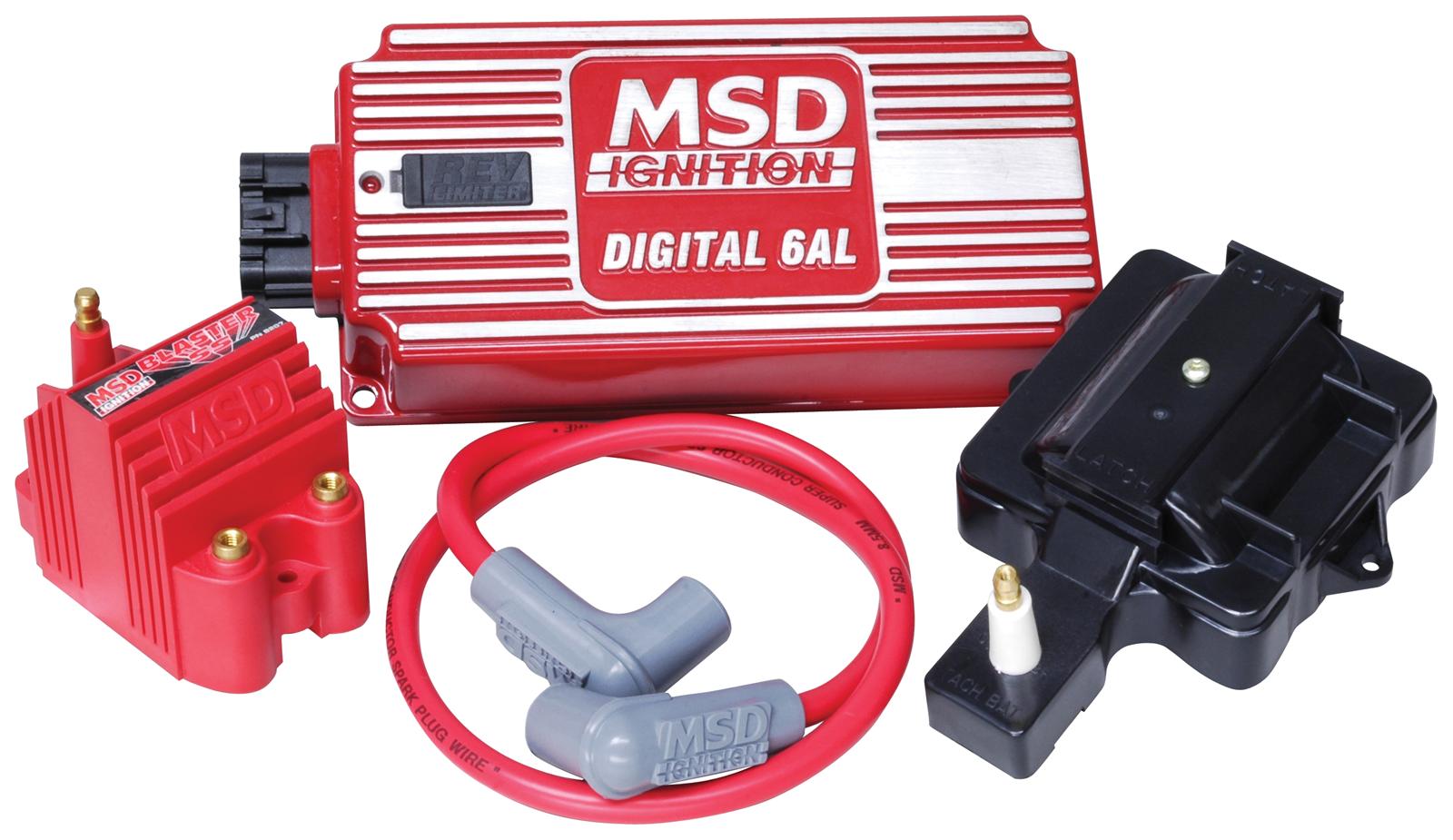

A while back when I was having ignition problems someone was kind enough to responded to my post recommending a MSD box they were using and it was in the 300. dollar range. I have gone back and looked for that response but I have not be able to find it. If you have that information would you please repost it. I apologize for asking a second time.

A MSD Digital 6A is $229. A refurb Digital 6AL is $263 and the Digital 6A Ultra is $300. They will all need a #8861 to bypass the 4 pin HEI module.
Digital 6A-Basic spark box
Digital 6AL-Basic spark box with limiter
Digital 6A Ultra-Basic spark box that's less than half the size of the 6A.

Is that for the TBI distributor or a points distributor?
