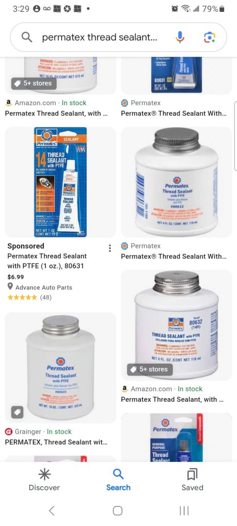

I’ve always used the same oil resistant RTV that I used on the end of the manifold, but Teflon tape may also work fine. I know they sell an HD Teflon tape (grey color) that is thicker and may work better.
6,445
10,970
This is what I use.

Will teflon tread tape work?
I don't believe teflon tape is made for that to be honest. The Arp thread sealant works well sealing just about everything on an engine.
The Permatex above probably works just as good too!
