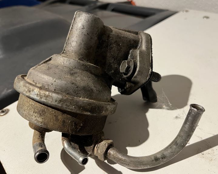

I have a related question. I included a picture of the stock mechanical fuel pump. Note that there are two intake ports on the pump. I presume the large one is from the fuel tanks (I have dual tanks). What is the smaller line for? I haven't traced back either line, but I'm hoping someone here has some insight. The longer line pointing up is the output (to the carb) from this pump.
If the smaller port is some kind of vent, what do I do with that line when I install the electric fuel pump?
