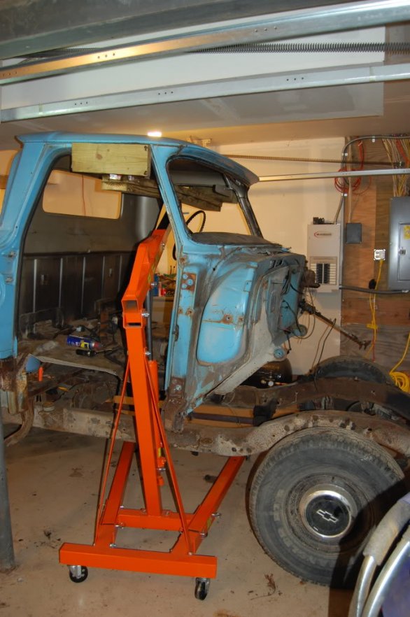

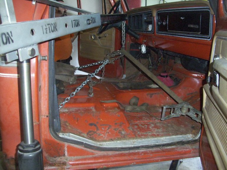

2. You will want to remove the doors and come up with a spreader bar to lift it with. I use a good 4 X 4 wood beam inside and it bolts up to an 1 1/2" pipe with a ring in the middle for lifting but you could also lift it like in the attached photos. If you run a strap through the cab to your hook you will wrinkle the roof and crush the drip rail. Also the weight can crush the front area of the rocker seam if it's not supported properly when you set it down The PO of this cab left that legacy for me to deal with.

I agree that repairing a cab with it removed is really nice compared to fixing one on the frame depending on how much repairing needs to be done but to get a good job of painting the floor it's the best way to go.
