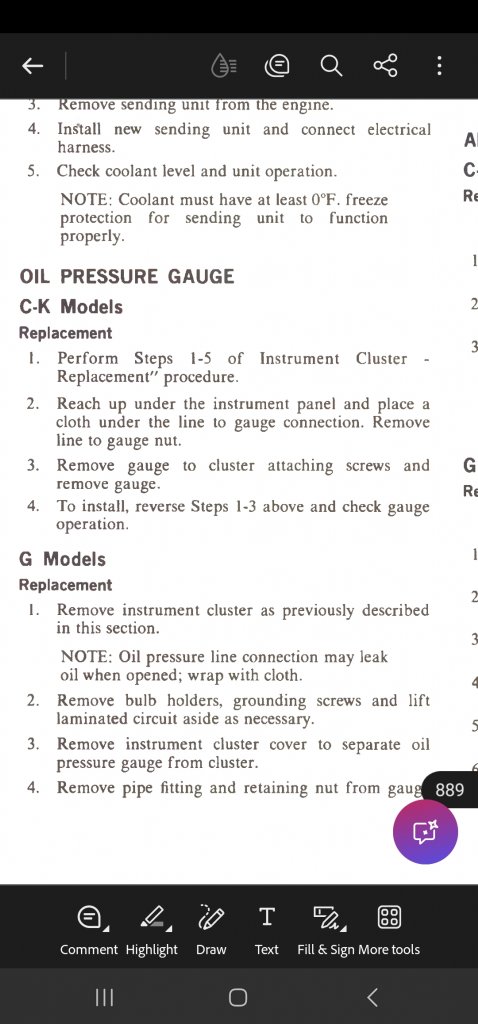

Ya. Manual says just reach up behind and take off the nut.
