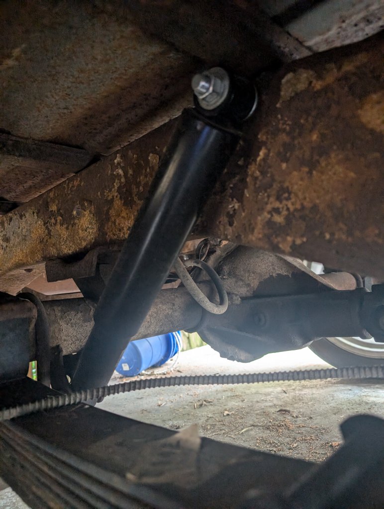

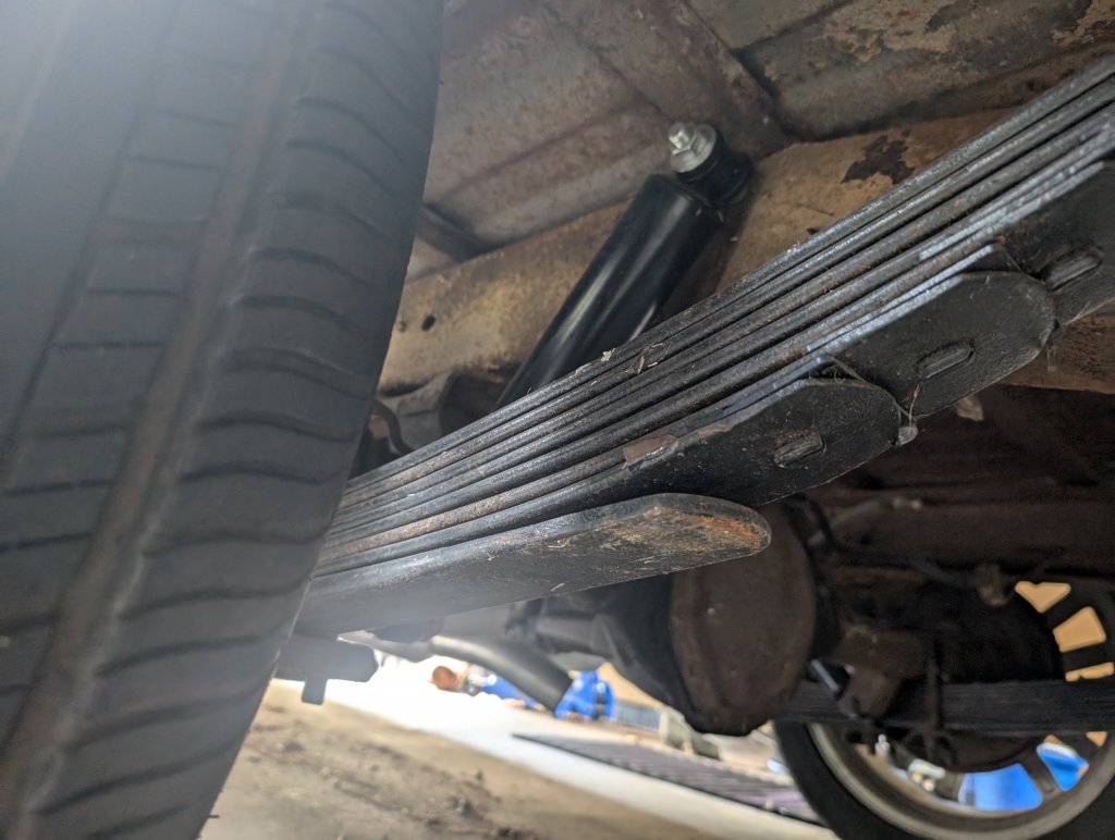

Well every suspension component is brand new and shocks are original length. Pics attached.

and upon posting these pics, it looks like I'm riding on bump stops in the rear as well. smh. sorry to waste you guys time. I new to the c10 world. any advice on the rear bump stops.

Nevermind. upon glance again, extenders are not there.
