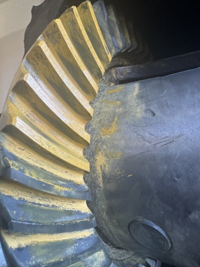

Rear gear pattern comments?
nelio
Sep 2, 2024
9
orange county
nelio
chevy c10
4.8

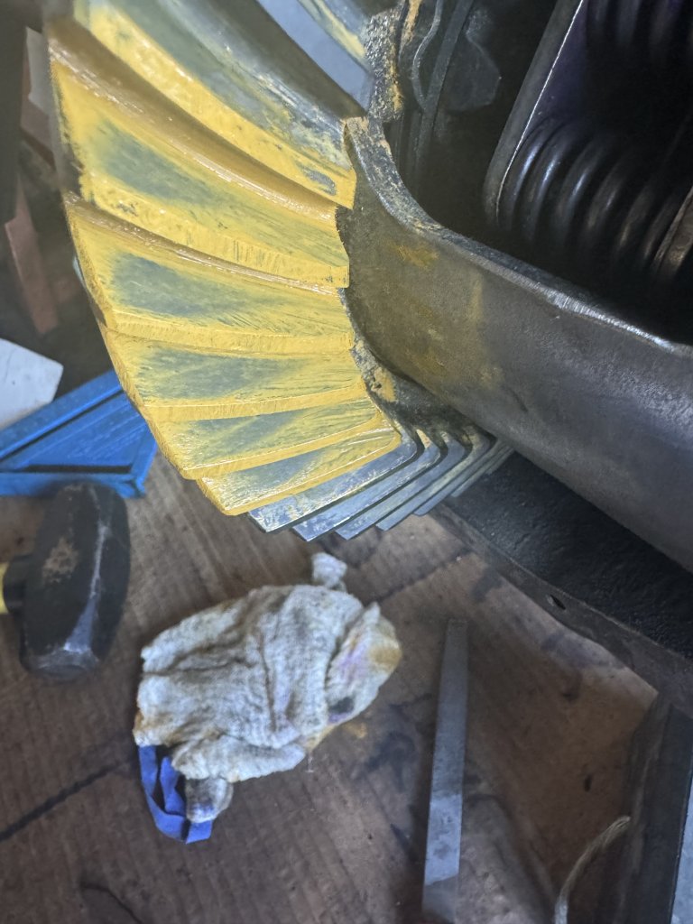

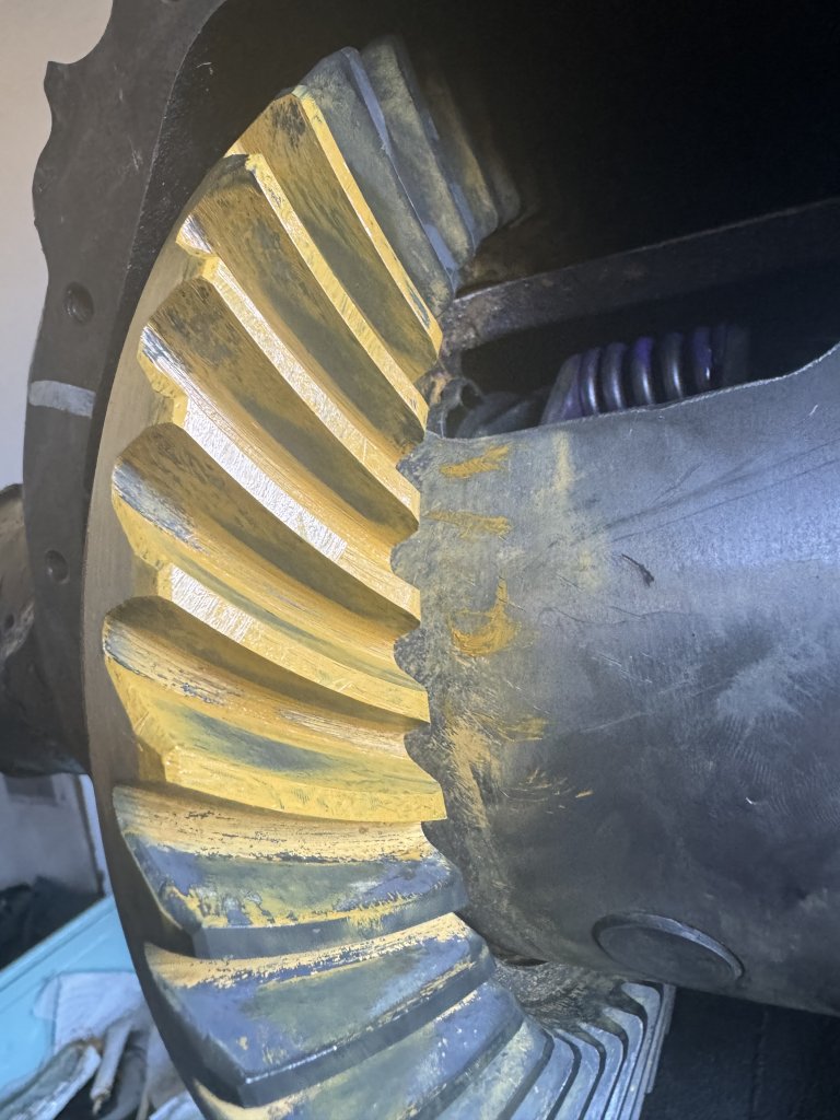

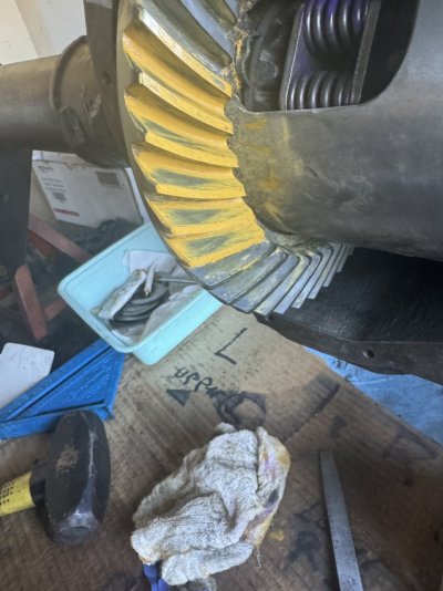

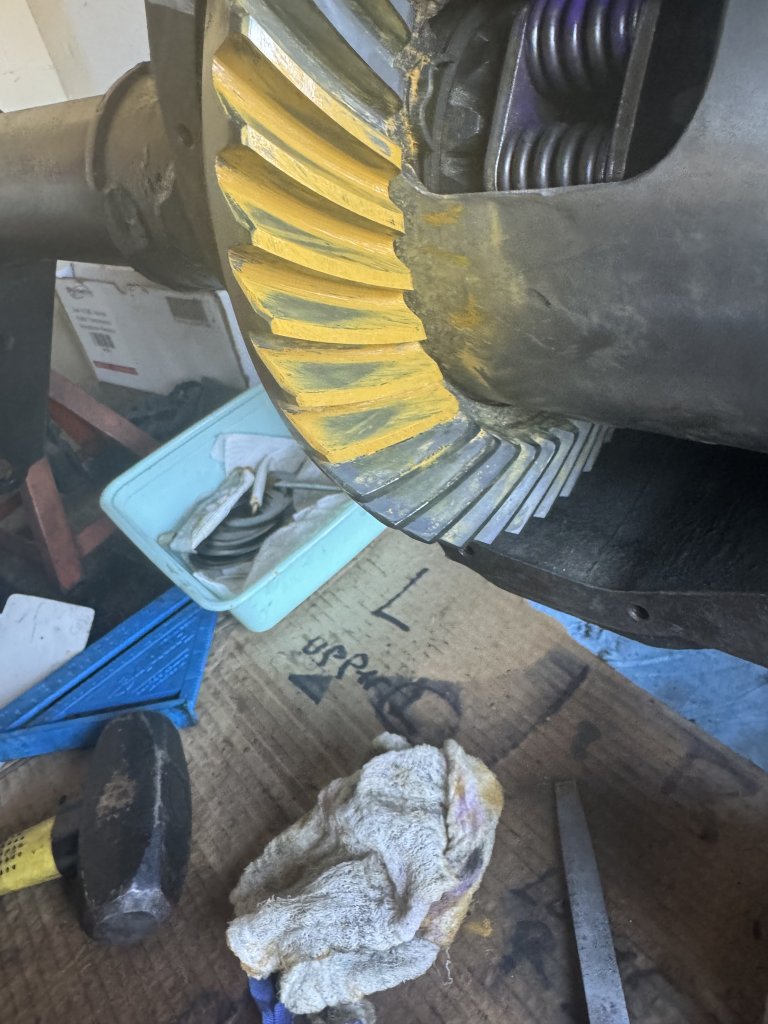

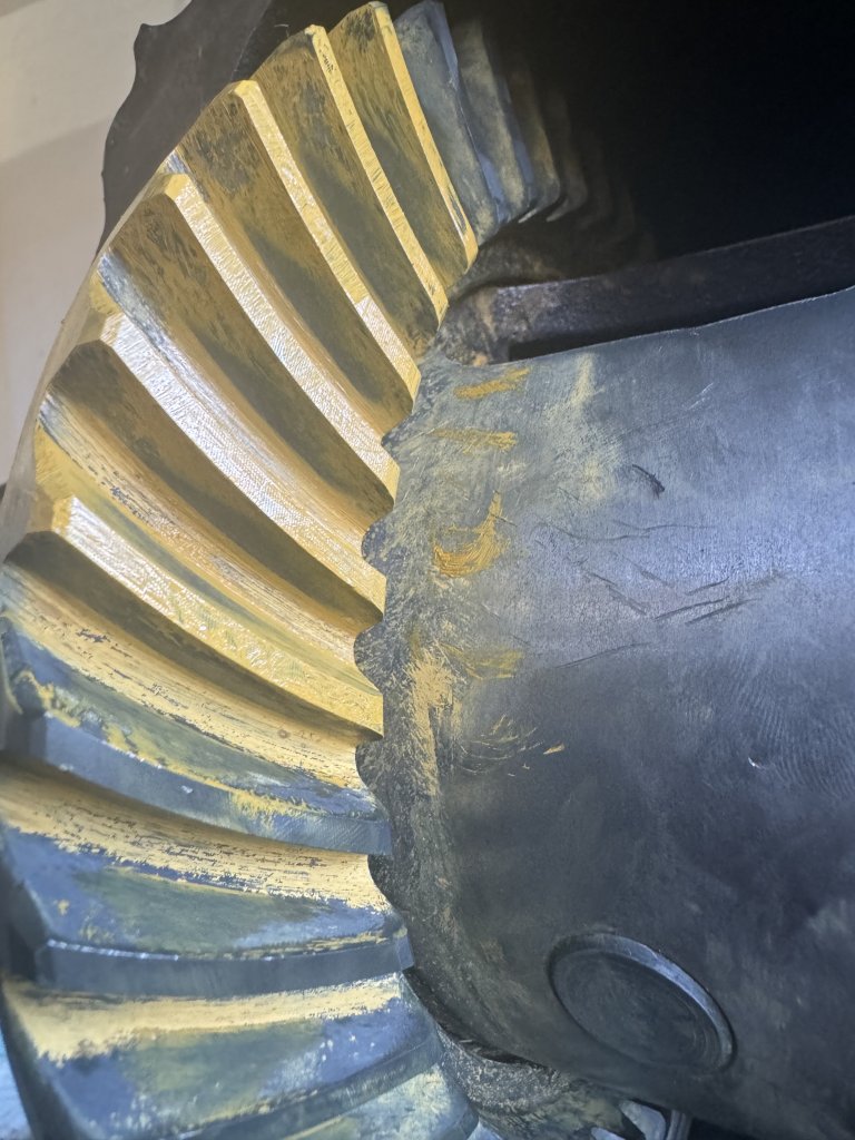

Got this pattern using the stock shim .
And .06 backlash
is this acceptable?

Too close IMO. Drive side has a hard line at the root and rounded at the top. Pull out some shim.

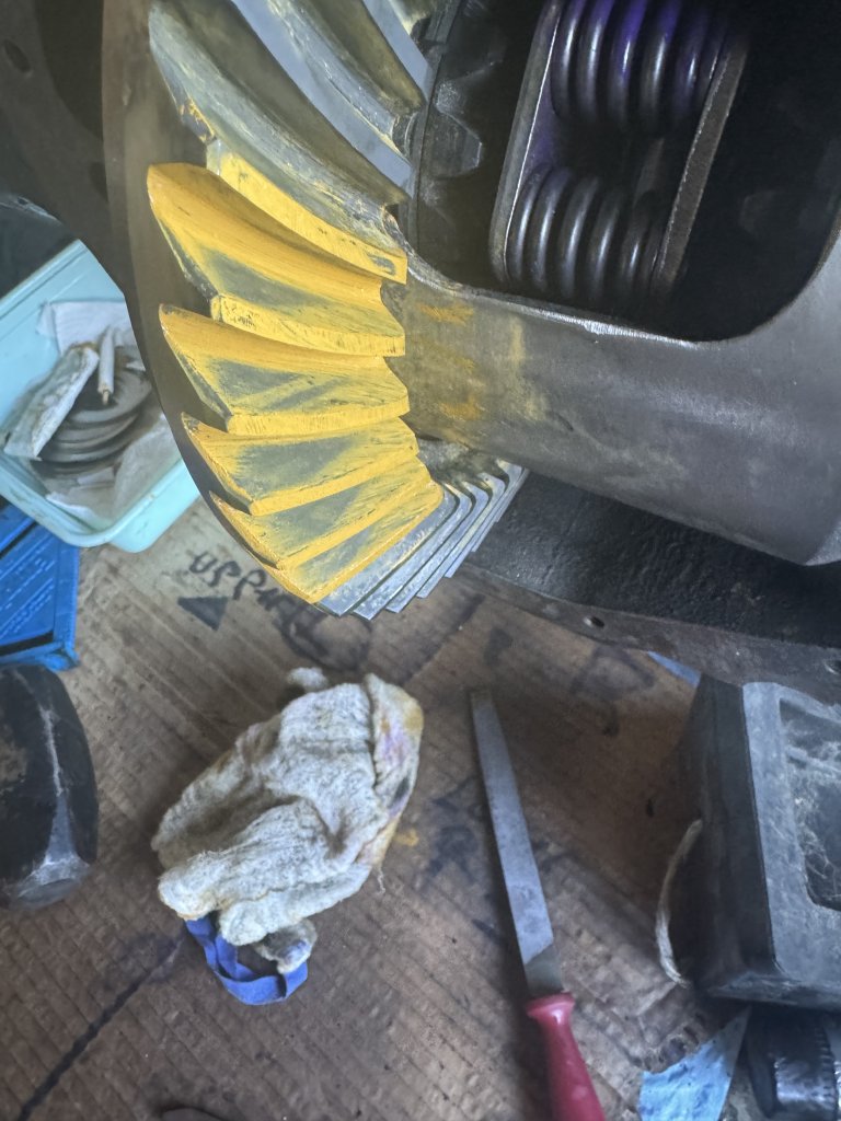

I'm going to post mine up here also so we don't have a ton of threads with the same thing. I think this looks good, but this is my first time. Thoughts?
If your backlash is good, run it. Looks pretty dang good. The pinion is just the tiniest bit too deep into the ring gear.

Run it
