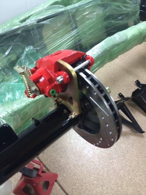

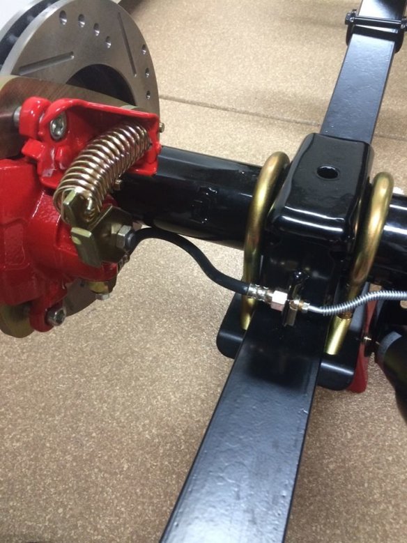

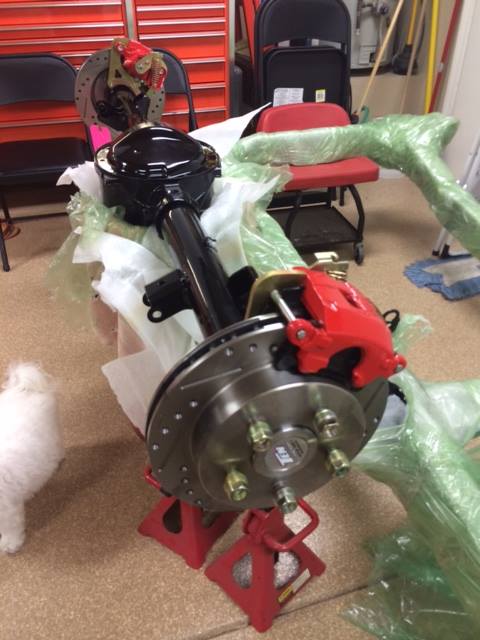

I have the CPP rear disc kit on my 87 GMC Stepside. The kit works great but the only bad was that the rotor was very thick and took up almost a 1/4 inch of the wheel stud so I need to get longer studs juts to be safe. Here are some pics...
And yes you need to remove the axles to install the kit, its easy to do.
