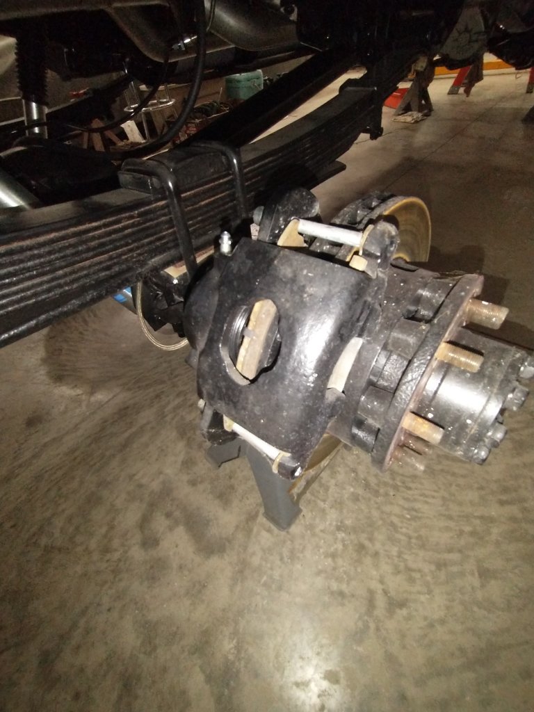

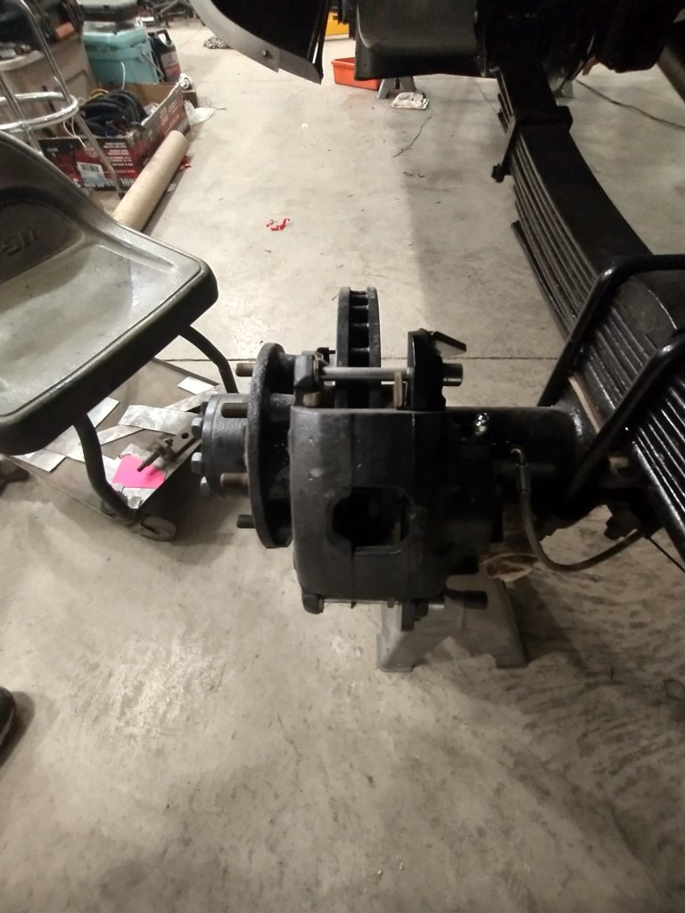

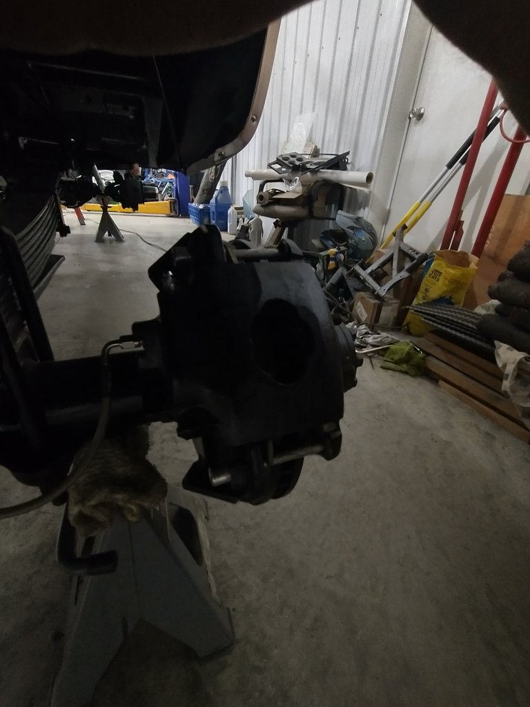

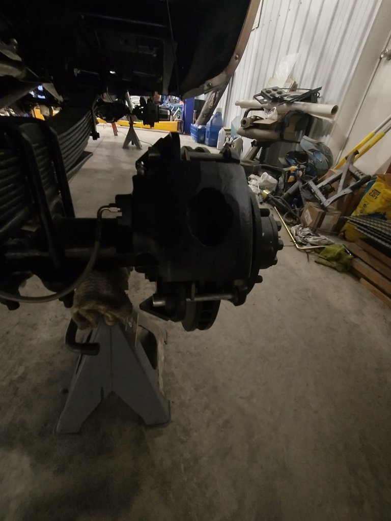

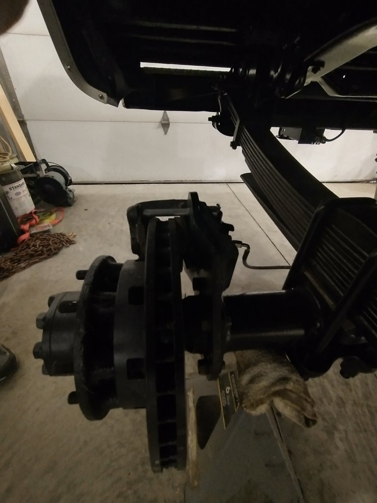

How about a few pics of the rear brakes, please?
