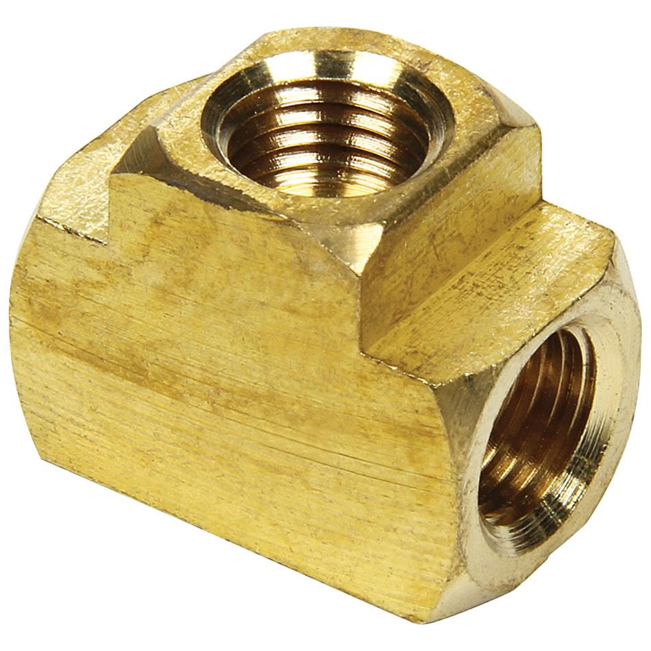

Iirc, that's how my '90 Suburban was setup. It had the rear abs and no prop valve under the radiator area. The rear lines just had a union and the front lines had a tee.
