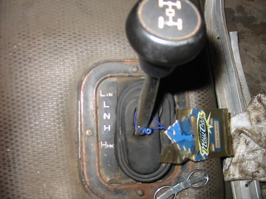

Gonna ask the obvious question.... You dont have a manual trans do you?
If not, one stick will control L-N-H gear selections, the other one controls loc-unloc.
Original shift pattern for a 203 is
Low-loc
Low
N
Hi
Hi-Loc
