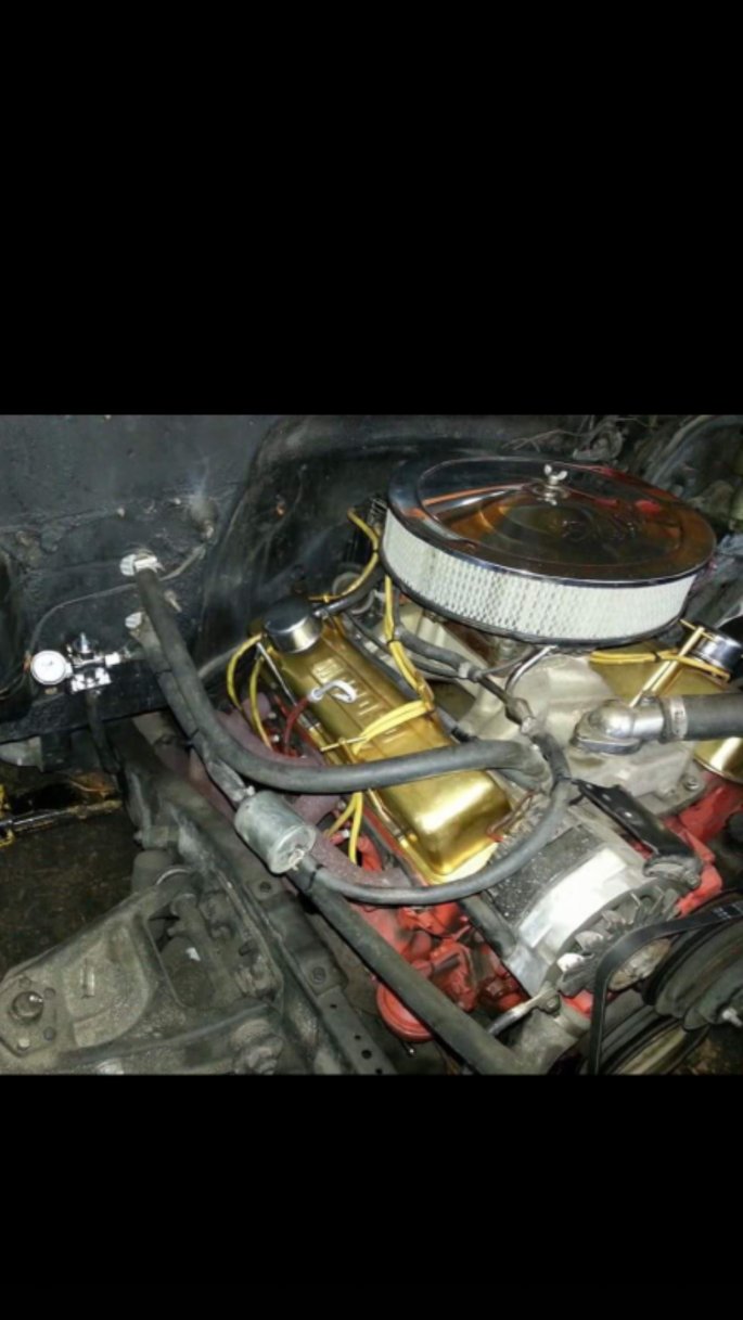

Hi all. I recently bought an '84 C10 with a 383 stroker. At least that's what I was told. Now I don't have a reason to doubt the guy, just want to know exactly what I have. How can I tell if in fact it is a 383? And also the rear main needs to be replaced, how do I tell if I have a 1 or 2 pc rear main? I've been searching for what seems like forever and can't find a definitive answer. Thanks in advance guys.

Without knowing the bore/stroke its tough to know if its a 383.
Regarding the rear main seal are the numbers still behind the alternator that will help you.

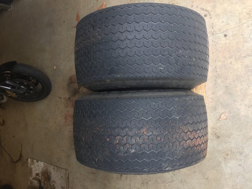

Haha MT 31X16.5X15 Sportmans aren't cheap...

It will buff out.

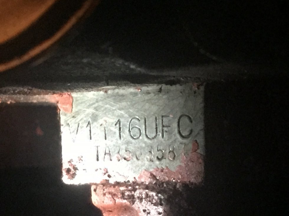

Seriously run your fingers down in front of the passenger side head until it meets the block. There should be a flat surface on the block. Take a picture and/or run your fingers along the top of the surface. The ID numbers are stamped right there. If you find a 010 on the end then it is a two piece rear main seal. That is one of the good blocks too. I would have said if the dip stick is on the driver's side it would be a two piece but I am not sure if this is correct.

Driver side dipstick is pre 80s so yes 2 piece rear seal. The 010 is actually on the driver side behind the head. Usually covered in years of grime and requires some cleanup.

Thanks for all the help guys, I had to scrape off the old orange paint to find it.

The last 3 characters... UFC
UFC
165
van, bus, a/t, Cal
Being its from 1980 it will be a 2 piece rear main seal as that didn't change until I think 1986 or 1987.
