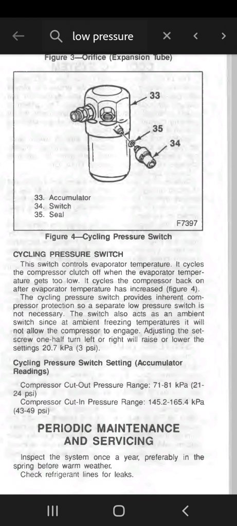

How would one go about adjusting a low pressure switch?
pop off the electrical connector to accumulator and there is an adjuster that looks like a slotted screw.
from the 1990 manual (your year may be different)

You can get a gmt400 low pressure switch for your truck. Just a thought.
Its like a 92 or 92 suburban low pressure switch i think
@Bextreme04 recommended it to me i think.
I did it. It operates at r134a pressures and should fit right into your air dryer.
@CheemsK1500
My bad there, 95 and up would be what you'd need in a gmt400 pressure switch.
My bad.
But someone already chimed in on adjusting it
