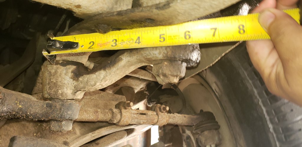

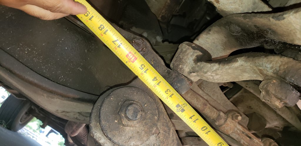

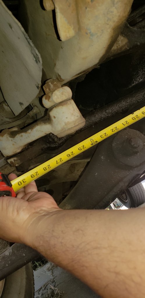

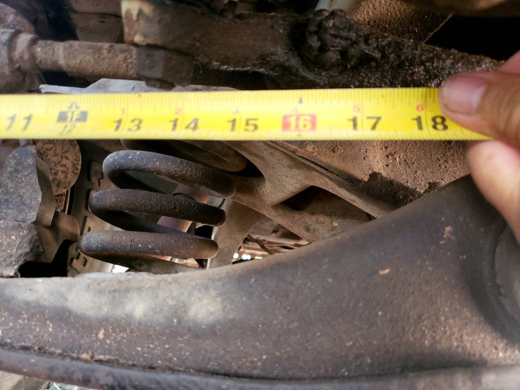

cannot adjust any of alignment points they are correct, tho i think i understand wat ur saying, if steering arm and center link do not realign remove or shud be removed first then find center gearbox, center of wheels, replace arm in position that works without moving, i think it is right, i'm thinking now wrong arm, either too long or to short, that wud cause oversteer one way not other, strwheel is perfect 1n3/4 turns each way, i did not check stops. pitman arm cud be wrong length cause same oversteer problem tho not sure bout pulling, steerbox more logical. this '81 nothing like '85, can you check lengths of yours. just to compare tho i have no idea without checking book specs, currently working on dirtbike, i have torn into a strbox, adjust play out, more likely pitman, unless theres like a center type stop or divet to cause pulling...thanx for idea gives me my first real option in 18yrs..:favorites37:

The difference in turning center left to right makes me think that someone got the steering box off center at some point. I would suggest you put the front end in the air and turn it full lock to the right while counting the number of turns of the steering wheel from center. Then check to make sure the spindle stops are actually touching the lockout. Then do the same to the left and see if it is touching the stops. Standard procedure on a steering gear change is to have the steering arm off the box and turn the wheel full stop to the left. Then turn the wheel all the way full stop to the right while counting the number of turns it takes. Then halve that number and turn the wheel that number of turns back to the left to find the true center of the steering gear. The gear will naturally try to return to that position, so you want to make sure the steering gear and the suspension are both in the centered position when they are connected together. I would bet that when your wheels are centered straight ahead, your steering gear is actually offset to the left, so when you let go of the steering wheel it tries to pull it to the right to center the steering gear.
To fix this, I would pull the truck straight into a shop so that I know the wheels are centered. Then disconnect the steering arm and find center on the steering gear by either of the methods mentioned in my post above. Then once the steering gear is centered, see if the steering gear lines up without moving the wheels at all. I bet they won't line up anymore. Then you just need to adjust the tie rods equal and opposite on both sides to maintain your alignment but move the actual steering position over to where the steering gear now lines up with the centered steering gear.
f u adjust rods you change toe...right? or shorten one side while lengthening other keeping wheels in same position...

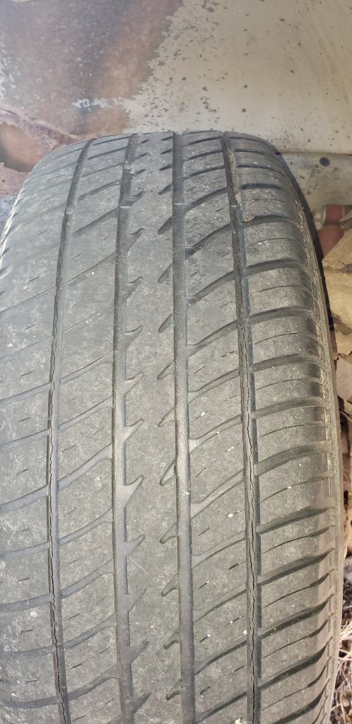

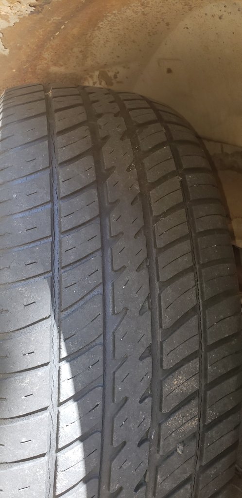

I cudn't find alignment specs in pickup, so they're around here in my office, i'll find them, i'm curious now bout them before i was frustrated it didnt fix issue...

I did alignments for 10+ years.
Right tire shows camber wear. Need to get different tires on it as a starting point. Will never drive correctly otherwise.
jesus... those tires are completed F'ed. I wouldn't drive anywhere over about 20mph with that kind of obvious dry rot... they are a ticking time bomb waiting to explode. I just replaced some older BFGoodrich that were starting to dry rot and were about bald. The difference in steering feel and sound level with some nice new rubber was incredible. Drives like a whole new truck now.

after 18 yrs thats gotta be the slightest of wear and i'm not worried bout that if i figure out causing pulling to right
and why i dont drive cross country, 18 yrs wat do you expect still like new looking at tread depth

Cross country has nothing to do with it... I don't think I'd try driving those tires down my street. That is exactly the kind of tire that has a catastrophic blowout and takes out other parts of the vehicle or causes a rollover. I think you have your answer on how to fix this though:
1. Get new tires.
2. Check that all steering components are properly centered
Camber split WILL cause PULLING. Uneven tread wear WILL cause PULLING. Old tires could very easily cause PULLING. The truck needs a good baseline to diagnose the issue. There is a bunch of people on here that KNOW how to fix vehicles. If you not going to listen to suggestions, why ask? I'm out.

18 year old tires? Replace them and you’ll probably be good to go! Tires arent supposed to be in service anywhere near that long.
9,559
17,538
@greyghost, you initially said no tire wear. Assuming those tires you posted, the worn out sides are the insides, either you have WAY too much toe in, or extremely bad camber angles.
Those tires are evidence of a gross misalignment of some sort.

Toe out sir, toe out. Toe in eats the outer edges. A pull is most likely a camber and/or caster inequality.
It is hard to tell inboard from outboard on those pics.
