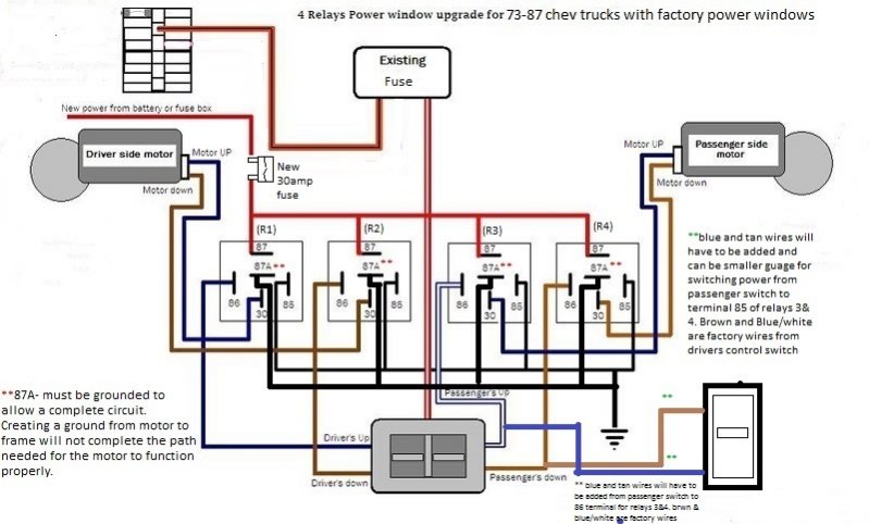

Try getting rid of the factory wiring and go with relays.
