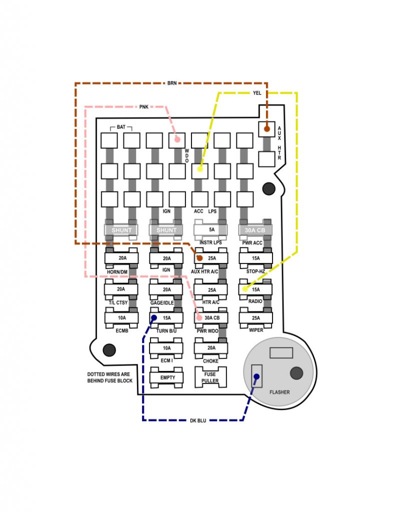

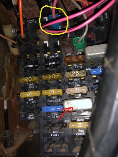

From my 85. Yellow circle & red arrow are power windows.
Second image- look at dotted pink line
