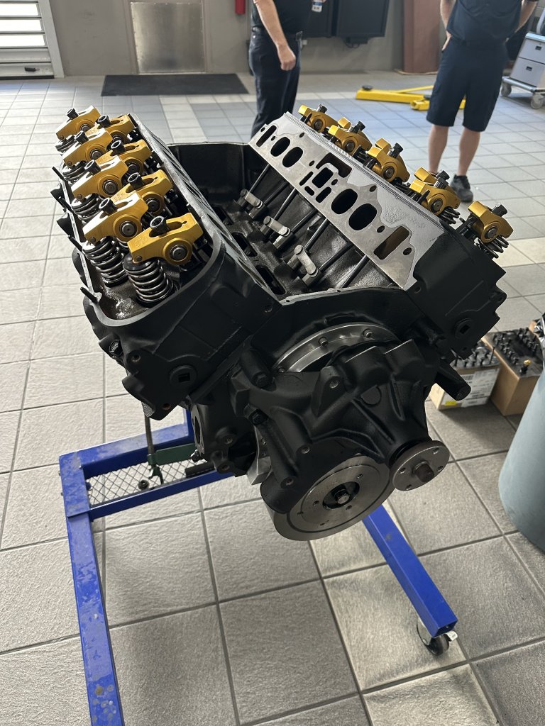

Howdy all,
We had our 454 pulled and rebuilt in the c20 suburban. We used king bearings throughout and converted to a hydraulic roller setup through Howard’s Cams. The engine was bored .030 over to 461 cubic inches.

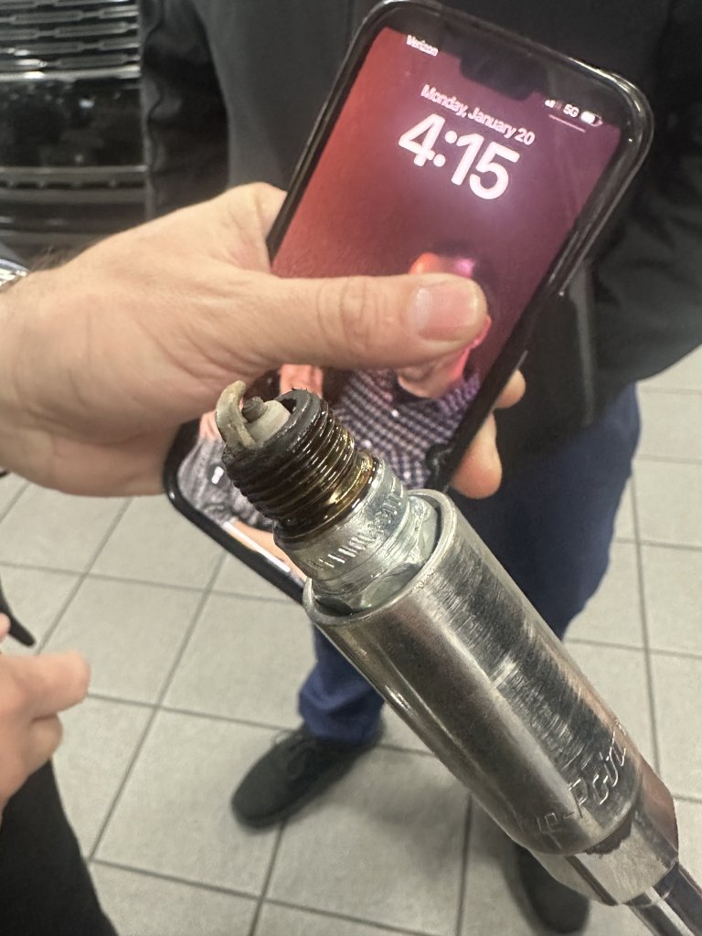

So far I’ve put around 1000 miles on it and it’s consuming around .5 to 1 quarts every 300-500 miles. No smoke, no Pcv issues (Wagner with a catch can), and the engine has tons of power. We did a compression test and all the cylinders are excellent. Plugs look clean, etc.
Howard’s recommended a GP1 10w30 oil. Our oil pressure is awesome, (55-60 at cold idle) and then when warm 30 at idle.
Do these big blocks like thicker oil? Wonder if I need to change to 15w40?

I wouldn't be worried at this point give the rings time to seat,keep monitoring it it should start to taper off. If you don't see consumption decreasing,then worry. I'm also assuming you have the pcv hooked up correctly and 1 valve cover vented.

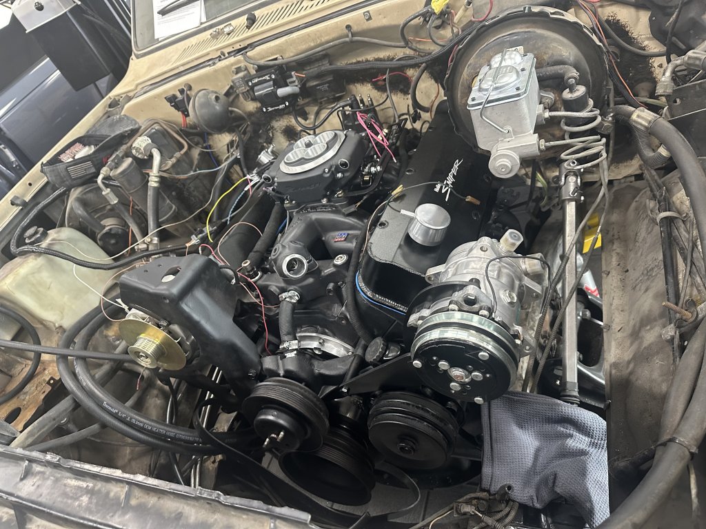

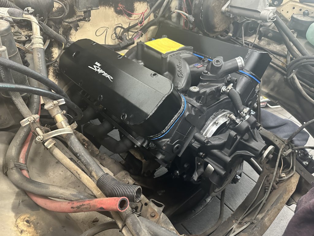

Correct. Wagner Pcv fixed orfice settings on the driver side cover, monster breather on the passenger side.

yeah - I would "start" with break in procedure. Hopefully the shop will have given you a list of "do's and dont's" when you first picked it up. If the bores have glazed over, you will never get it back( ie it is the mechanical seal developed between rings and bore, not oil viscosity that will set performance ).
I would go back to the shop that did the work, and have a detailed discussion with them about how the truck was first run in. The first 20 mins can affect the performance ( or lack of ) for the rest of the remaining engine life. You may be able to get it back with a hone ( and new rings ) etc. - but I would get the shop that did the work to advise you on options...

I can't imagine a situation where an engine loses that much oil and doesn't smoke like a SOB or leave a LARGE puddle of oil everywhere it goes. My truck leaks a bunch, leaves lots of drops of oil everywhere I park... whole underside near the engine has oil on it.... maybe 1 quart every few months. My honda daily was using up a quart every month or two also and that is with ~250 miles a week of driving. It smoked like crazy because the rings had totally gummed up and stuck in the piston ring grooves. I pulled the head and pistons, put new valve seals in, installed new rings after cleaning everything up and running a ****** ball hone through it... no more smoke or oil consumption since.
A quart every 500 miles is A LOT. You are either leaking it or burning it. If burning it, you would be smelling and seeing it. Plugs would be VERY fouled.
