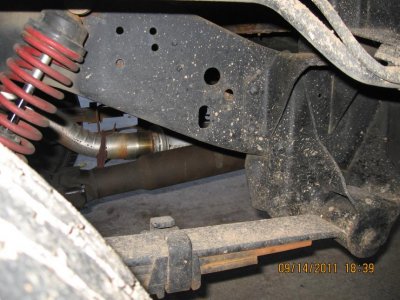

No, I didn't have the frame out, just spent half the winter under there knocking the loose **** off and spraying what I could. I got some rust bubbling through on the frame above the driver's side front axle near the shock mount, but I just sprayed it and didn't knock the loose **** off. I will be taking care of that area this winter.

Here is my spray can reformer frame.

That looks as good as factory to me! Nice work. We on here always get more out of the pic than what was intended, soooooo........
I see you've got a coil over type shock there. That's not stock or OE replacement, is it?

It's been painted about 9 months +/-.
Since you have the frame out you can do a lot better of a job than I can. I can only reach so many places with the spray can under there.
