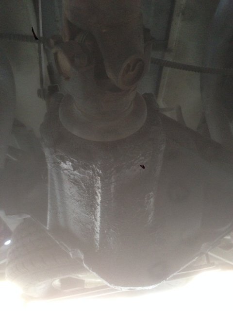

please take look at this picture about to purchase c20

this c20 has 36k original miles, what would all this oil be a sign of??any ideas will help, thank you

Thats just a wore out pinion seal, Unsure about on a 14 bolt, but my 12bolt seal I changed it in 5 minutes.
24,922
7,066
Yeah it works now, I fixed the img tags. Like Trevor said, most likely pinion seal. Anybody here know if that seal can replaced without messing with the gears? Just pull the yoke and slap a new one in?

I have done a couple of mine and I marked the nut before removal , then put it back to the same mark , (maybe a tic more) , and used lock tight. No problems , it takes a lot to crush the crush sleeve.
However I did it two man style by hand , not with an impact gun.

Marking the nut was 1 thing i forgot to do when i did mine.
89S, It doesnt mess with the gears as long as you get it tight, usually about the same tension as befor.
Hirsch: Yeh i 2 manned it also, I had a buddy hold a pipe wrench on the yolk and i had a flex handle on the nut.
Total time on mine litterally took 5 mins, a kid timed me lol.

Could be the gasket between the housing and the pinion support too.
