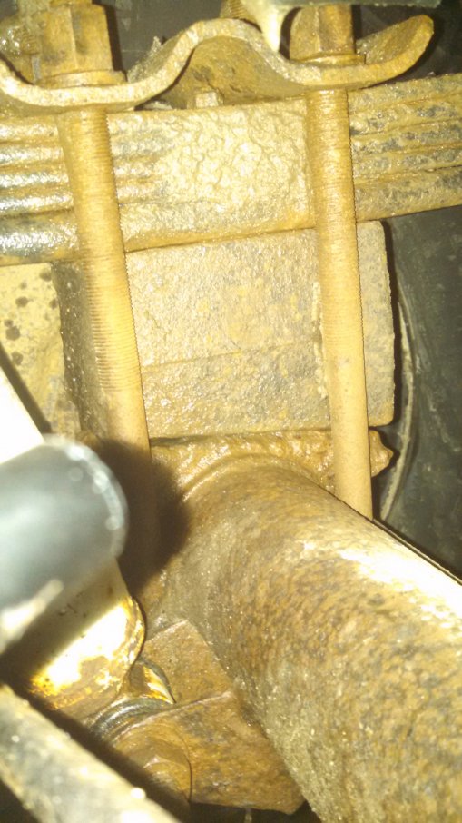

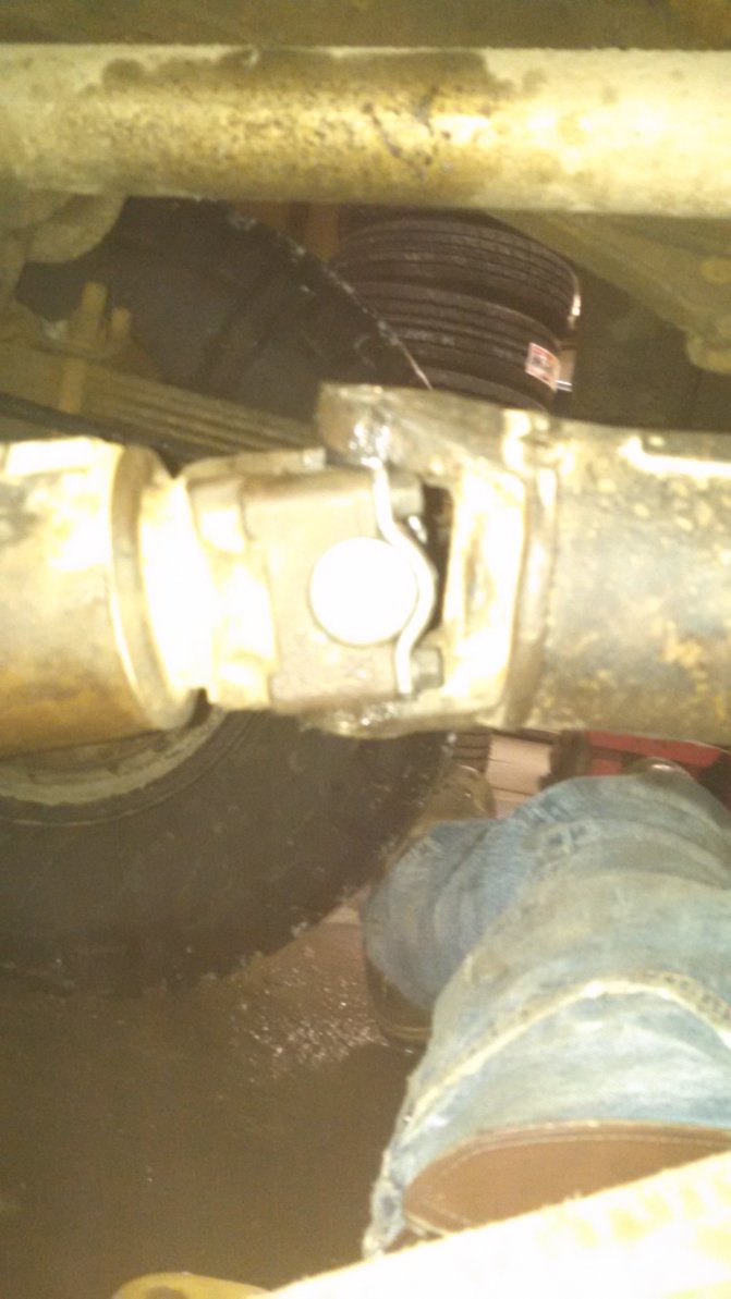

I'll be the first to admit I'm an idiot if I can learn from it. But did I install my lift blocks backwards?..

I am confused. Is it shearing the straps and bolts right off the yoke??? It should give you plenty of warning before throwing a shaft out like that. Maybe the straps holding the caps aren't tight enough and stretched? Do you have the c-clips installed on the inner side of the u-joint caps? That should keep them from slipping through the hold down straps?

No it has the proper clips but there is a serious vibration coming from the driveline. I got new straps the last time it came out. Oh and they're tight.

In the picture on the left, is the other end of the driveshaft in the transmission?
