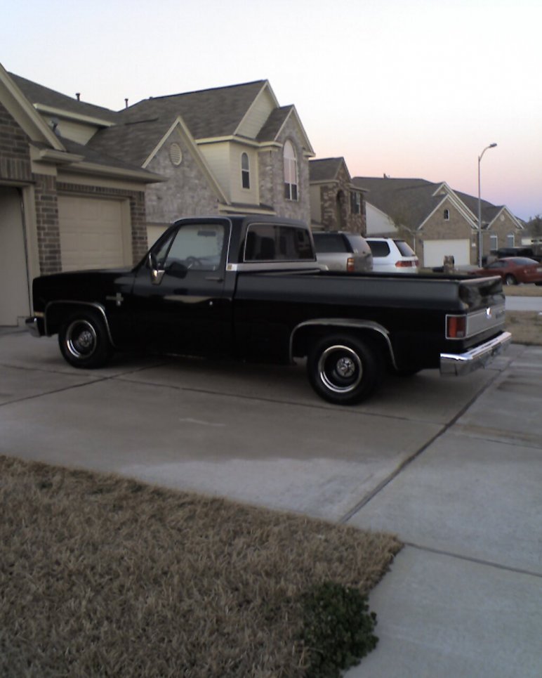

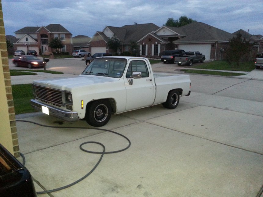

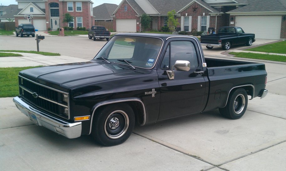

I have a 84 Chevy Silverado that is 100 percent stock. i want to drop it just can't decide on 2.5/4 drop or 4.5/6 drop. i will be running P275/60/15 tires on truck. Any pics would be of help. Thanks and have a great day. :cheers:

82 Chevy
350ci
2/3.5
4.5/5
4.5/6

J Knight do you think i can run P275/60/15 tires with the 4.5/6 drop. Thanks for posting pics.
You would probably be better off with a 3.5/5 drop running 275/60/15 tires on the front.

What size tires are on the white one J? Also thank you for your input on the subject.
