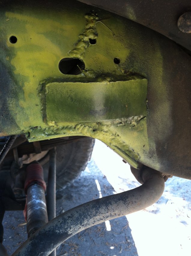

Ok, so it is pretty common knowledge that the frames on the older Chevy's crack at the steering box due to the pressure. Anyone ever hear of this happening on the passenger side in the same area? Would the frame repair kit work on the passenger side? I have only seen the repair kits and support arms for the drivers side.
I am looking at buying an 87 and the frame is cracked on the passenger side. They repaired it by welding a plate to it, but concerned that it occurred on the passenger side.
Thanks

can you post a pic. is that a straight front axle? highdesertranger

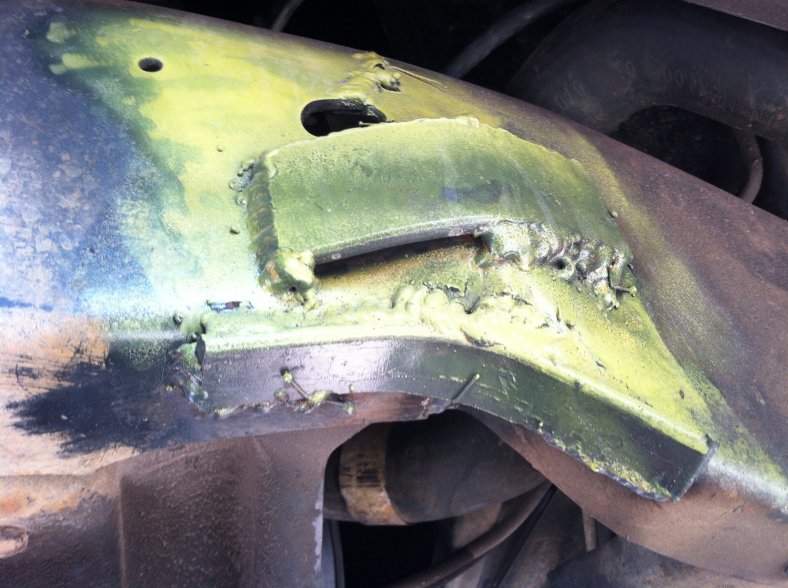

As you can see, someone already tried, emphasis, tried to fix it. I will have to correct their welds, which I can, but just never hear of this occurring on the passenger side.

wow I have never seen it crack there. wonder if it's been in an accident? any thing else damaged, like the cross member? no you can't use the steering box repair plate because of the dimples for the box bolts. if this is the only damage I believe you could fix it. 1st remove that metal that someone welded on, reweld the cracks as needed. 2nd grind everything just smooth. 3rd on the under side cut a v into a piece of heavy angle iron ben it so that it fits the curve of the frame. 4th weld the angle in place flush with the outside of the frame at this time weld the v you cut. 5th take a piece of heave plate cut it to match the frame and the angle you added. 6th weld it in place, it's better if you stitch weld this as opposed to one continuous weld. 7th weld the cracks on the inside of the frame. do not grind these welds. 8th wire wheel everything and paint. or you could just find a good frame and swap. good luck. highdesertranger

Geezus.. That is damage from being hit or something. There is nothing on the truck that would cause that damage there.
